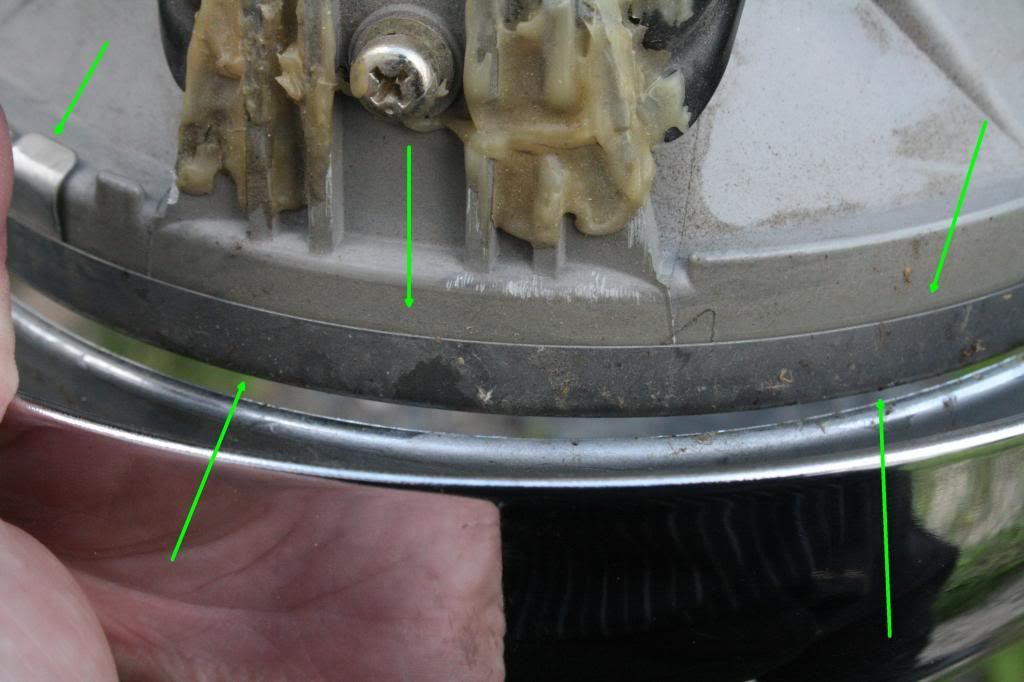

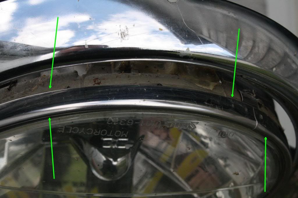

I have a 1997 GL1500C - the Australian model.
The thin insert rim on my headlight is damaged, but i cannot locate the part number for a replacement. I purchased the large front rim (Part No. 33101-MZ0-671) thinking it might come with it, but it didn't.
I have attached a link to a headlight that includes this part. You may have to scroll through the images. It is referred to as the "dust cover" I think.
Without it, there is a 1/8 - 1/4 inch gap between the light and the rim.
Any ideas?

Rumpole,  like others have said the ring is part of the headlight. A google search of the part number 33120-MBH-671 shows the ring attached.
You could also do a search for wrecked  Honda SHADOW AERO - VT1100C3 as it uses the same lens.
http://www.motosport.com/AU/cruiser/oem-parts/HONDA/1999/SHADOW-AERO-_-VT1100C3/HEADLIGHT
The ring is purely decorative and doesn't affect the function of the headlight.  Unless it drives you crazy, I would try and find a busted light to strip the ring off.
