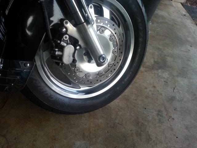

Here's my front wheel after using the California Custom products. I could do a MUCH better job if I pulled the wheel, which I'll do before winter. But even with the limited time I spent on it, it looks like chrome instead of aluminum. And it doesn't require a lot of elbow grease.
I'll be ordering this stuff again.

Well I found a place local that sells it so I picked some up. Got the deoxidizer and purple polish. $15 per bottle. Tried it tonite and feel its ok at best. The deoxidizer did nothing, no cleaning, no turning white, nothing. The polish turns black fast but leaves the marks and stains behind.  I did the brake lever and part of the wheel. No way does it look like chrome.  Just my two cents.
