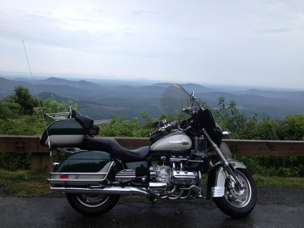

A shot of my ride on the way back through the BRP
Simply beautiful shot. We will be up there in October ourselves. Staying in Maggie Valley for a week or so. Your bike looks so familiar...... cooldude

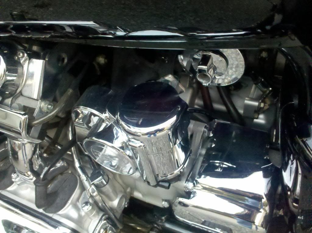

Get a Stebel.   cooldude
http://www.stebel.it/stebel2012/products.asp?IDserie=14&uso=1&IDprodotto=53&tipologia=moto
This is where/how I mounted mine.....
I got a short (3 ft....but you won't need all of it) piece of 1 1/4" wide by 1/4" thick aluminum flat bar from Lowe's.  You can find it where they sell metal sheets, angle, threaded rod, etc.
It's light, very sturdy and easy enough to cut and bend to shape.
I put a sorta z bend in it to off set the horn back some.....drilled a mounting hole at each end and mounted the horn.  Easy peezy.
Just make sure you use a relay.

BF, I liked the position of the horn, that clever it looks like it come with the bike.  cooldude
