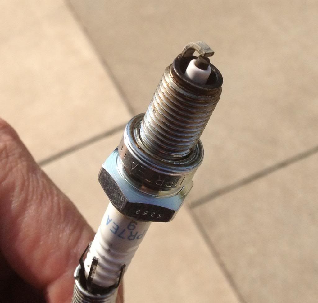

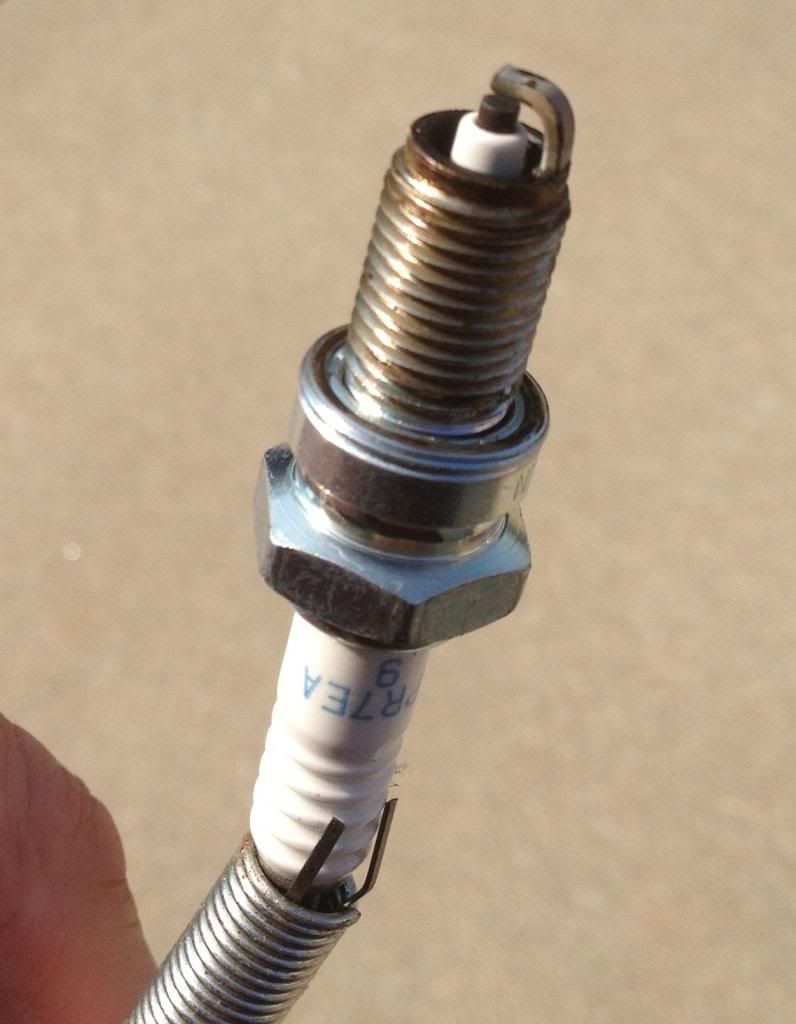

Ok, he replaced them with original NGK plugs gapped to .32.  I did take off the three plugs that are accessible without taking the pods off.  They look very lean to me, but I would like your feedback.

+1  cooldude The plugs do look like it might be running on the lean side.

It doesn't look like it is running lean to me.
Actually looks a little rich running.
Source:  http://www.dragstuff.com/techarticles/how-to-read-plugs.html

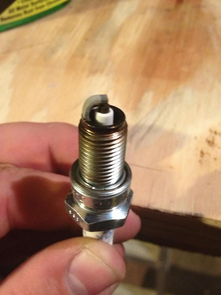

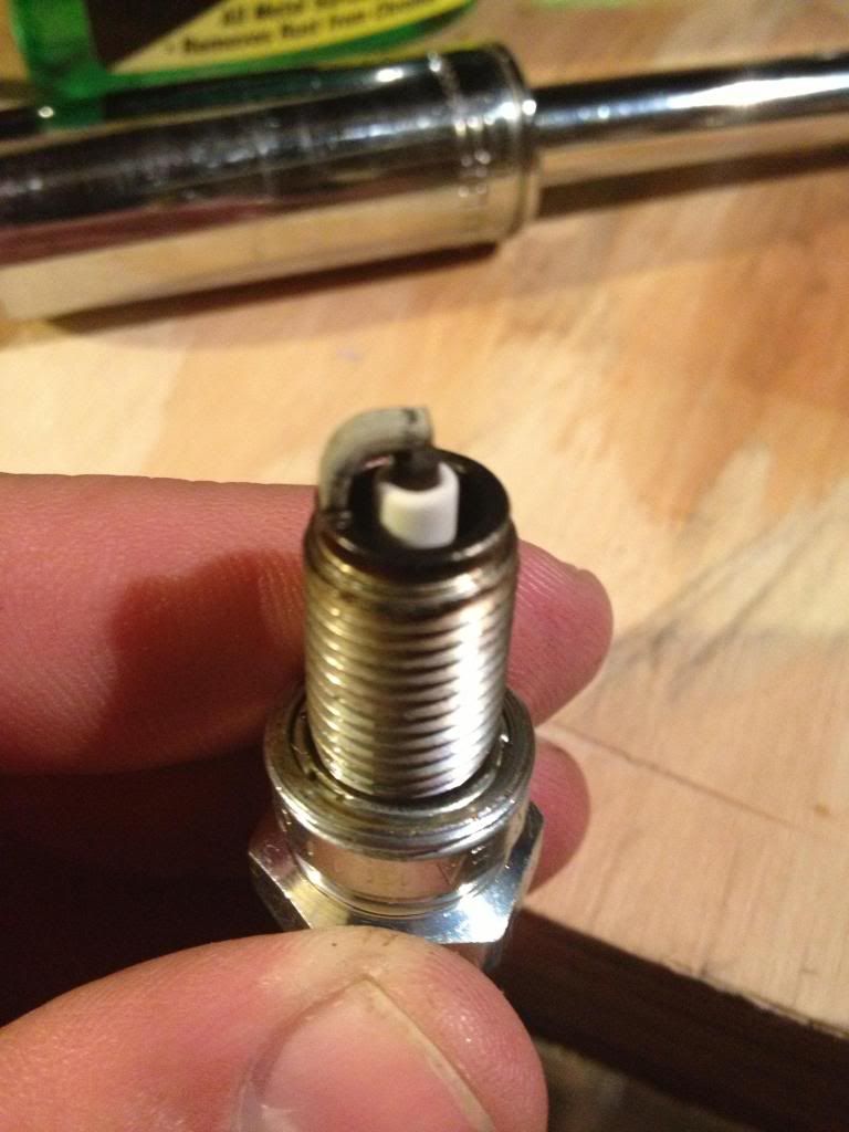

ok.  clean gas. 80 mph, cut power while accelerating.  pulled clutch and coasted to a stop.  pulled plugs.  and here is what I got...
let me know what you think.......

Looks fine to me - no problem with mixture.

+1  Undecided Undecided those plugs look just fine IMO.
