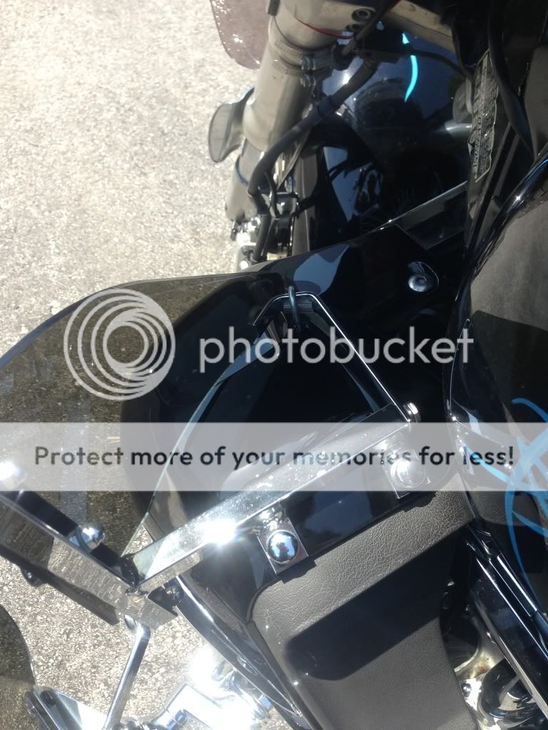

I took a 1/8 welding rod and beat the flux off of it and made a loop in one end cut it to proper length and a L shaped bend in the other end. Took the top mounting bolt of the pod out and with a rubber washer bolted the rod on so it holds the front of the airwing bracket down firmly. I put 1/8 shrink tape on the rod so it is flat black and will not rust. Can't even see the rod if you didn't know it was there.

i put a black quick tie around mine works great
