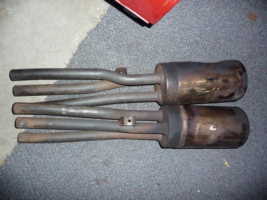

I think one of the best mods to increase the exhaust note and make this beast scream like a banshee at hi rpm is the one pictured below.  The stock tips and chrome stacks are replaced with a 36 inch truck stack with a 4 inch id as I remember. The muffler is carefully sawed off at  7 1/4 inches and you can see what the internals of the exhausts are.  It is best to remove the exhausts from the bike and use a metal cutting band saw to get a nice square cut ......when you reinsert the piggies/canister into the truck stack, it helps seal the joint if the cut is nice and even.   You will get a bit of exhaust leakage noise with this method but because of the ease of removing or reinstalling the piggie/canister section....I don't mind. I get a drone because of my helmet but use a 27 db ear plug and its ok and I can still enjoy the exhaust note. The left canister slid into the 36 inch stack nice and snug like, but the right one required a bit of filing and gentle hammering to shrink some high spots so it would slide in by hand.   It might be my imagination but my butt dyno says I get a few more hp and there is no need to change the stock jets......
« Last Edit: September 11, 2013, 08:46:01 PM by Rio Wil » Logged

i just got done doing mine. I used 4 inch OD stacks. I went a little further and cut more can off, more like 10 1/2 inches and tig welded my stacks in place so they will never move.

« Reply #4 on: September 12, 2013, 08:19:01 PM »
Yeah, one of the piggies has a mounting bracket welded on it .... just drill a hole in the stack to line up with that bracket and use a screw to secure the baffle.
What else would one use to get a nice straight cut on the baffle, especially to cut through the inside section separators.....or are you thinking a wood cutting band saw that stands vertically, vs a metal cutting band saw that lays down horizontally?

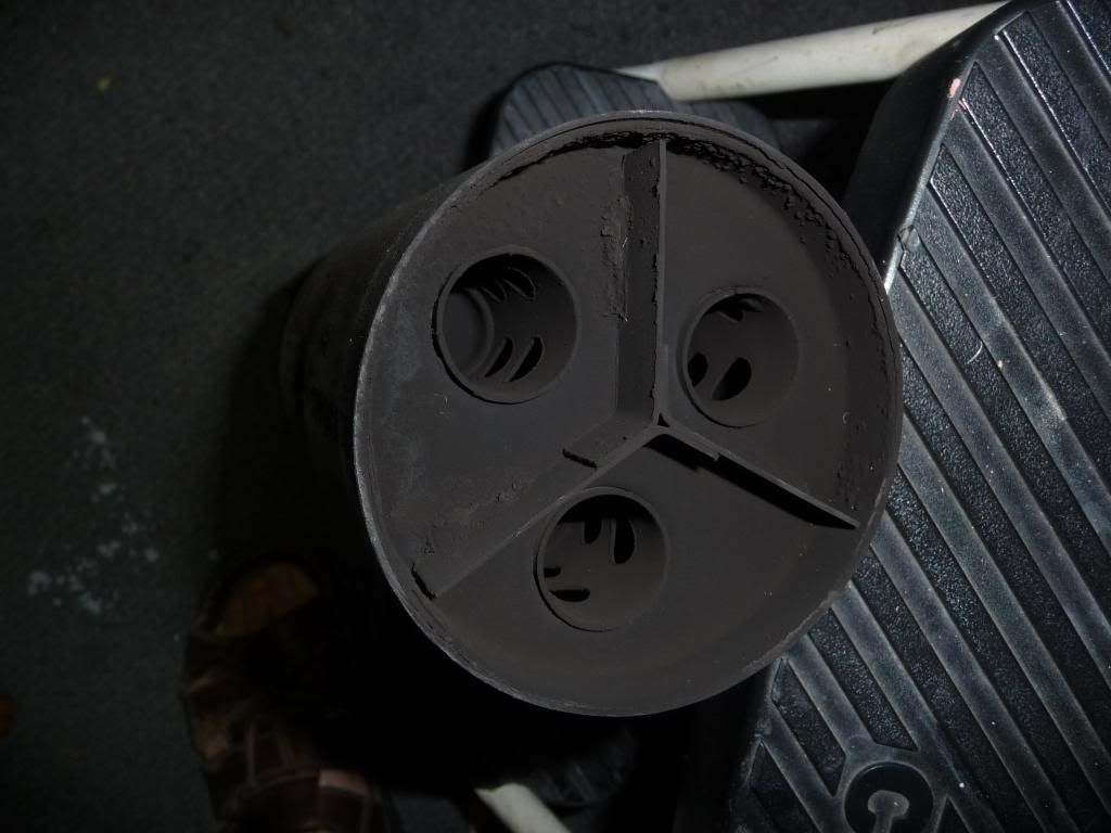

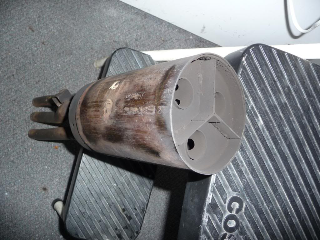

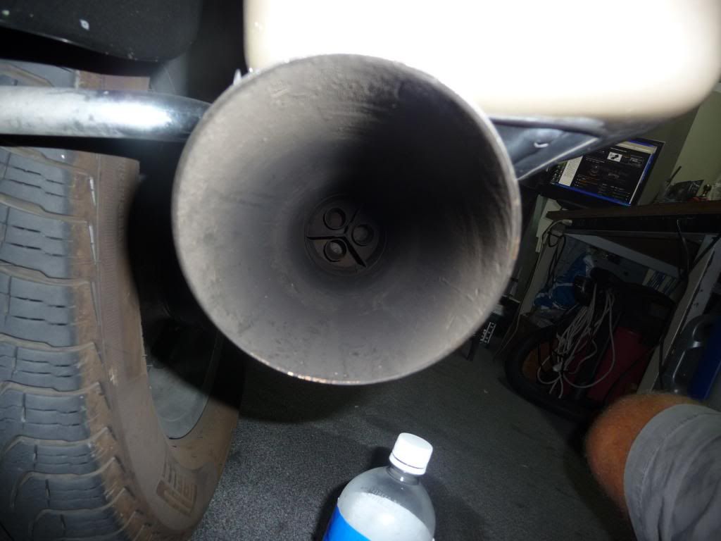

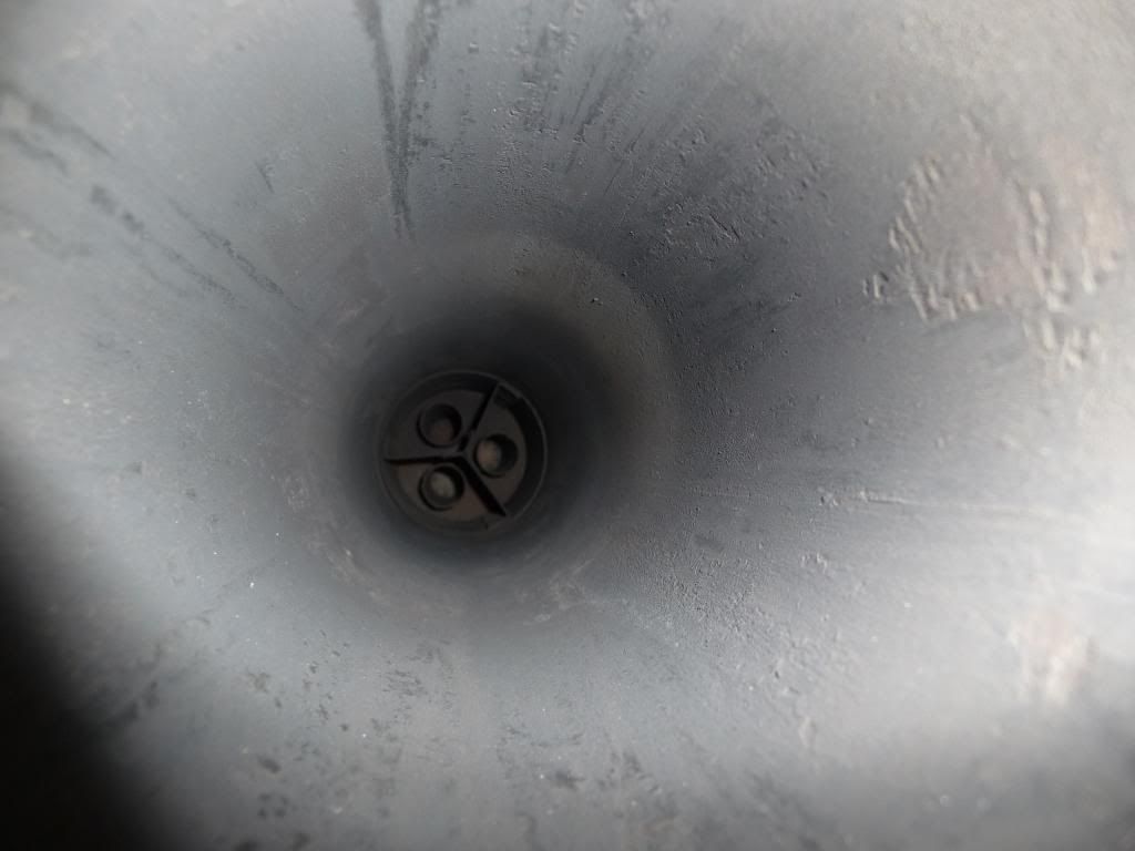

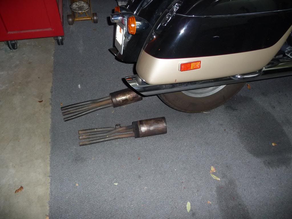

The idea is to increase the sound level of the exhaust, a quick and easy way is to modify the stock exhaust as shown.
The stock exhaust comes from the manifold as three pipes and to a collector where the three pipes enter about a 22 inch muffler which is covered by a chrome stack and terminates in the 3 piggies.
Just as a side note, the 3 exhausts are confined to their own route through the muffler and they do not mix anywhere in the muffler, all individual all the way out the piggies. There are three longitudinal sections to the muffler each roughly 7 inches long.
This mod cuts off the "rear most 7 inches"  (excluding piggies) and removes over one third of the muffling capability....ie, considerably higher volume.
The rear 7 inches and the front 7 inches are basically identical, the middle 7 inches is simply 3 chambers the exhaust travels through to get to the rear chamber. The little fins you see in my second photo actually extend about 7 inches to the front of the muffler.

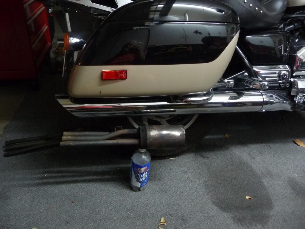

So the mod is, cut the rear 7 1/4 inches off the 22' muffler (with piggies intact) slide the new stack up over the remaining 14 inches of muffler and you have louder exhaust.  If you want quieter exhausts, simply insert the cut off section (with piggies) back into the stack and secure with a small screw....now you are quiet again, just like stock.... when reinserted into the 36 inch stack the piggies will terminate right at the rear opening of the stack, ie, they are inside the stack not added on  to the end of the stack.
The picture of the cut off section sitting on the plastic bottle just shows about how far the cut off section will go when reinserted into the stack.
Way wordy.....hope this helps.....
Oh, and yes you can just remove the stock tip and stack and slide the 36 or longer stack over the entire unmolested muffler.  It might be tight and need some gentle persuasion with a mallet, it will also need a slot cut in stack the same as the stack you take off.....this is where the muffler mounting bracket is....

To answer your first question, no, you do not have to remove the rear baffle section to install truck stacks.
The basic idea behind cutting off the rear of the exhaust can, ie, rear baffle section, is so that one can have a louder exhaust.
As in Rio's idea, you can reinstall the baffle section when one wants a quieter exhaust.
It's the same idea behind MarkT's silencers.  Take 'em out when you want loud, put 'em back in when you don't.
Alot of folks gut or take out the rear baffle section only to find out that the newly induced drone drives 'em nuts.
That's the idea behind putting the baffles back in.
