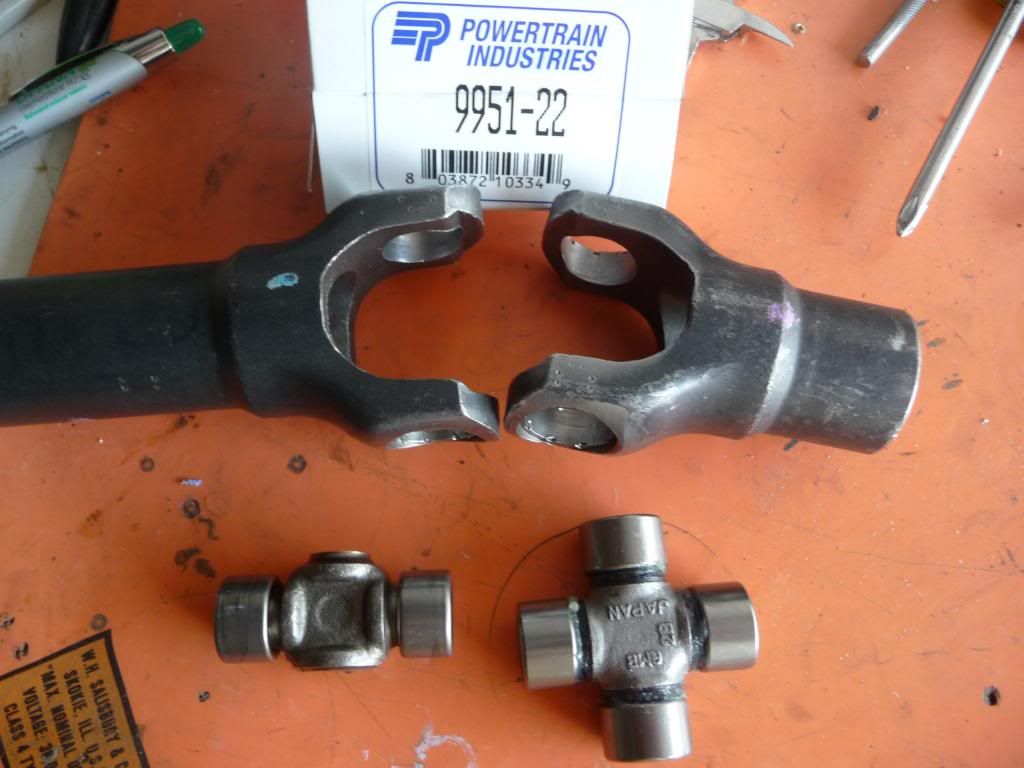

I called Drive Line Express in Redding, CA to order one of their upgraded ujoints and they said they were not going to be doing any more.  The volume was just too low to justify the set up costs so its a done deal.
I said I wasn't going to do this but based on the above I guess I will take on the project and see if I can make one.  Not going into production, but will make one.
I had a spare from eBay that was in pretty good shape, it had a tiny click that could be felt by chucking one end up in a vise and attempting to rotate the other end with a pair of channel locks.
All four of the cups were nice and tight in the yoke so the yokes should be usable.
The below pictures are the start of the project and I am ordering the Precision Universal #392 today from some where on the internet and have it delivered.

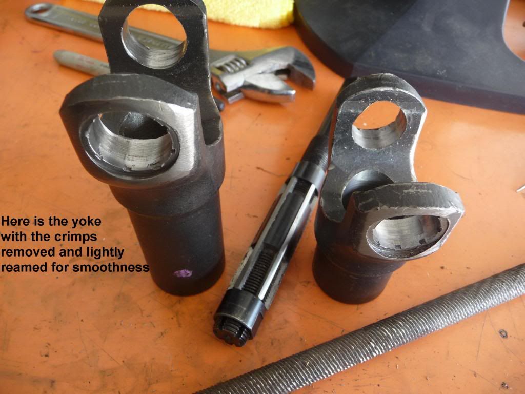

So the yokes are pretty much ready to make the cut on the inside of the yoke where the c clips will reside....probably will just grind the flats rather than try to cut them, but will have to whip up some sort of jig to hold them, probably mount on a rotary table so I can be sure to get a perfect 180 degree rotation to make the second cut and insure both cuts are parallel.

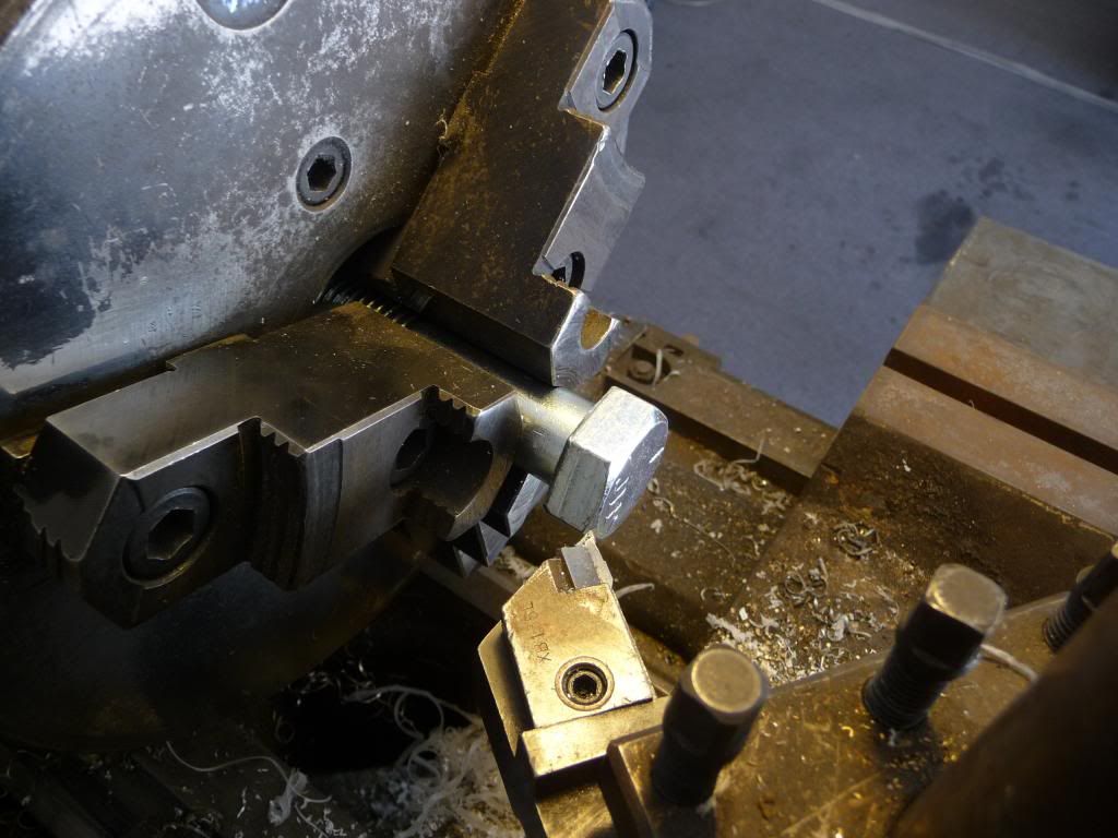

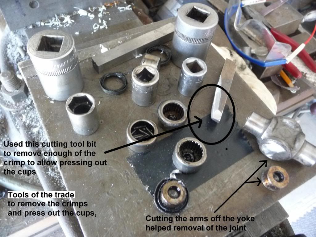

Removing the crimp was pretty low tech....just ground a cutting edge on the tool bit and used a small hammer to gently tap each crimp from both sides and essentially shaved them off.... Smiley

Yeah, I saw that was a tool you ground out of a piece of HSS, I thought it was for a lathe.....  looks like it all cleaned up nicely after the pass with the adjustable reamer. Good start
......    I was picturing a complicated clamp up job on a face plate,, trying to get it centered perfectly so the crimps could be cut out on a lathe, you know, three hours of work to do a twenty minute job     .........

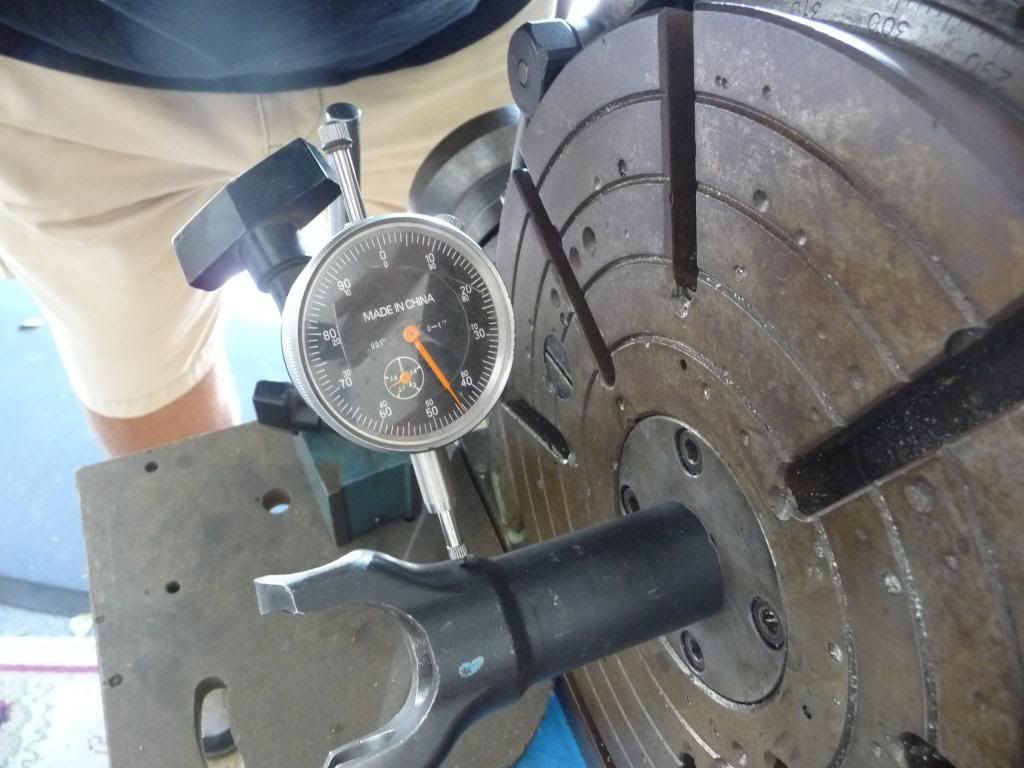

This is a continuation of the previously posted 3 photos.......

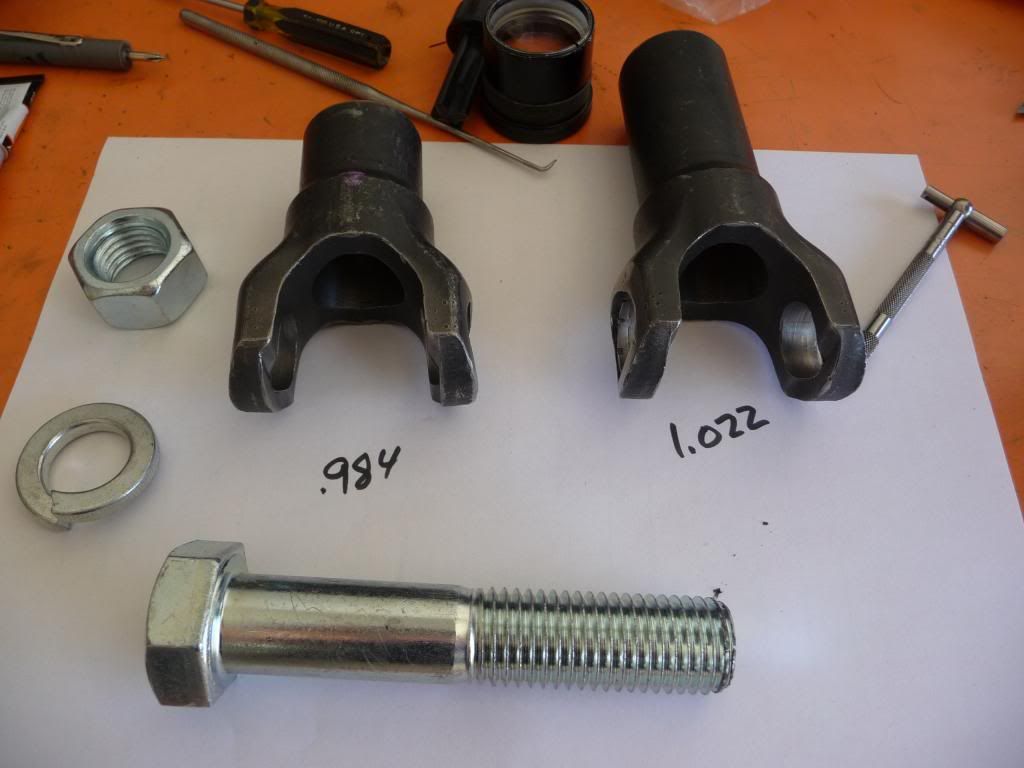

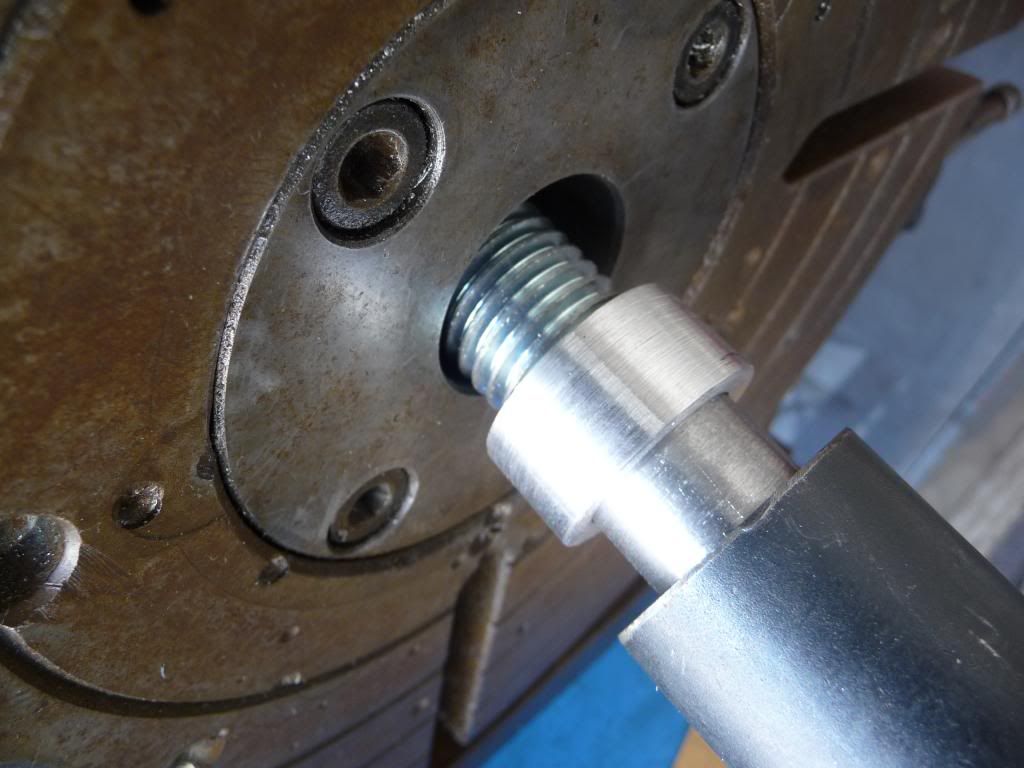

Need a simple method of making a jig to hold the yoke reliably on the rotary table.....this big ass bolt should do.... coolsmiley
Needs a bit of reshaping.....the head will grip the splines inside the bore
Fits nicely......
The hole in the rotary table is a bit big so I need a slightly tapered bushing to take up the slack abd center the yoke perfectly.. cooldude
Made it out of aluminum ........and while on the lathe, files a slight bevel to match the table bore..
Looks like it is sturdy enough......
Run out is pretty good....about +- .001 at the base and +-.006 near the cup holes...may have to check that out further.....
Interestingly enough, the bore and spline  i.d. of the short section of the joint is considerably smaller than the longer section.....ex. ....about 1.022 for the long part of the joint and .984 (bore id not spline id)
That says I will probably need to round up another big ass bolt and machine for the smaller portion of the yoke and not molest the bolt for the bigger portion.......not sure why other than to preserve the first bolt dimensions....
Next is to select an appropriate  grinding wheel, it looks like only a small amount needs to be ground to establish a flat for the c rings and and the internal dimension needed to install the c ring on the cups.

"Run out is pretty good....about +- .001 at the base and +-.006 near the cup holes...may have to check that out further....."
Not sure about your rotary table, I think mine has a Morse Taper 2 hole in the center. Would something like this cut to size help give you better alignment?

The runout at the base of the yoke is fine.....the .006 at the yoke ears might be due to not being tightened down yet....I just threw it on the table turned the nut and took a preliminary measurement. This part appears to be forged and not turned so the outside dimensions are suspect......have to check the inside dimensions around the cup area for actual runout.
Having never done this before, I am not sure how much misalignment is tolerable before it translates to either vibration or undue wear on the bearing cups.....so will try to keep it to a minimum with out getting anal........ 2funny  At highway speed this thing is turning some 2000-2500 rpm, so it needs to be fairly well aligned.balanced.....
I think I have a coffee can of collets around here somewhere but it seems they were a shorter collet than seen in your link.  The hole in the table is 1.250 on the surface and 1.100 on the back side over a 2.500 inch long bore....Not sure what MT that describes......my Bridgeport is R8, but don't know about the table.....all in all, it should be an interesting project.

That be a MT4 taper in your table,,  what is that, a twelve inch table?? must be fun to move around. Mine is an eight inch and weighs 62lbs or so...

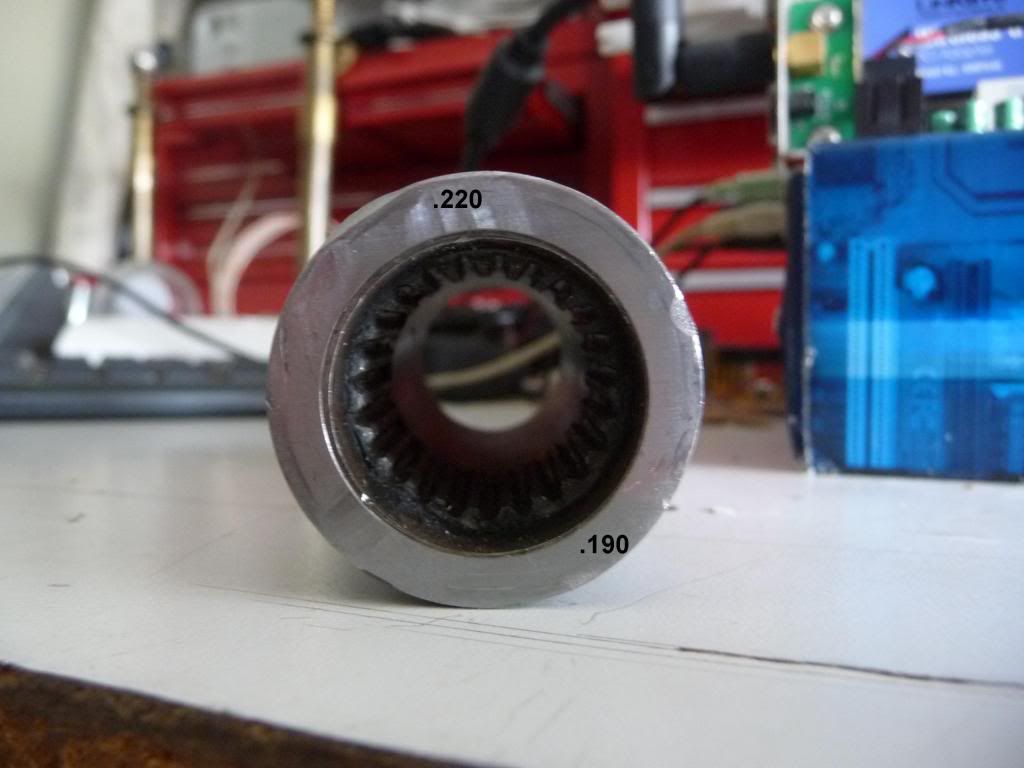

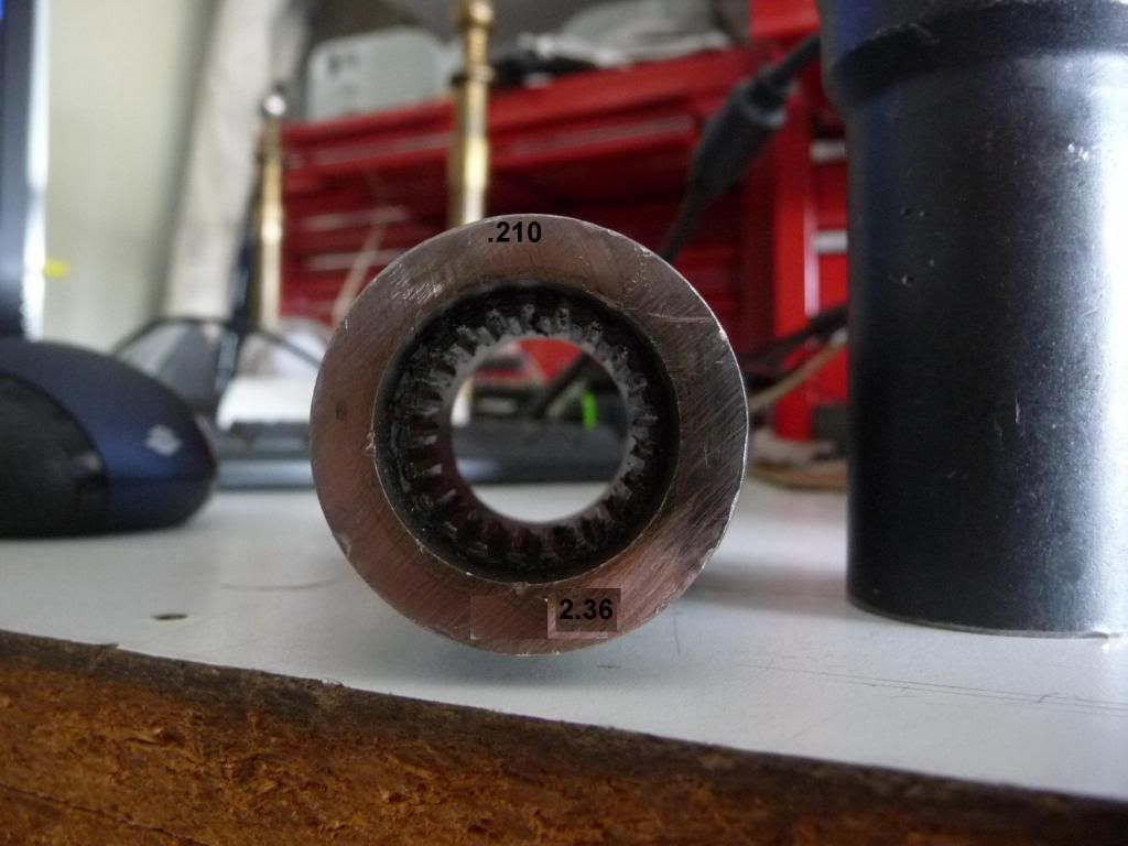

This is kind of interesting, the side wall thickness is off quite a bit around the circumference, this photo is the long piece of the yoke.  The interesting thing is, if you indicate on the bore of the splines, the runout is only about .001 vs the bore being offset by some .015.  So, from a rotational balance perspective, this is out of balance by a crescent shaped sliver of metal some .030 in the middle and tapering to zero at the tips.... Undecided
Pretty much the same with the short piece of the yoke

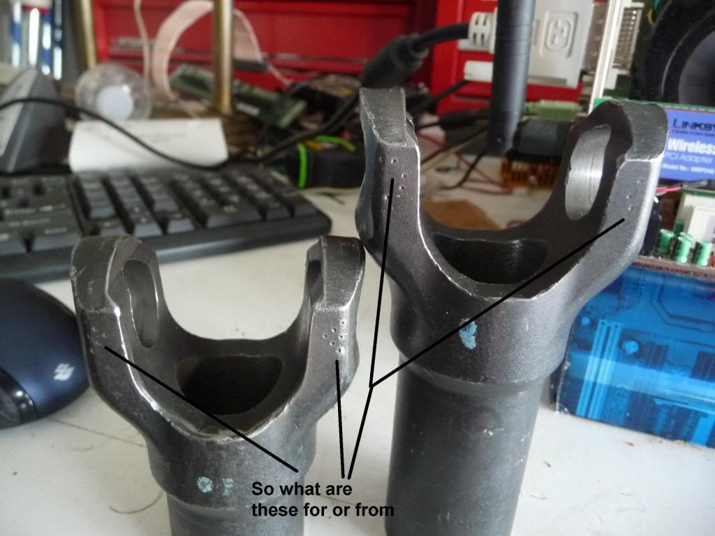

Another curious thing is the punch markings on the ears of the yoke.....are they a code of some sort to define the (for the lack of something better) a pitch and/or yaw characteristic of the bore relative to the centerline of the spline......At first I thought they were from the jaws of a vise or some other tool, but they are seemingly punched by design.. ??? ??? ???
pancho
Posts: 2118
Bonanza Arkansas
« Reply #11 on: October 06, 2013, 08:04:39 PM »
Well, while universal joints are precision products, I believe they are mass produced, not individually hand constructed..... so I would not think that the marks are some complicated individual balancing code,,, the offset of some of the relief machining steps you measured seems to indicate that PERFECT balancing may not be as critical as one might think...??? I tried to do a bit of research on  u joint manufacturing and did not come up with anything pertinent. I guess I would chalk them up as manufacturing marks and move on.  If I read you right, the minor and major of the splines are centered in the forging within .001  ??

Correct, it seems the bore for the splines was cut on center, the splines then cut/broached, then the bore was enlarged possibly for clearance for the drive shaft, but the set up was rough and the bore was offset cut.....curious.
One would think the little punch marks would be symmetrical if they were tool marks and not triangular, crescent or random in shape......

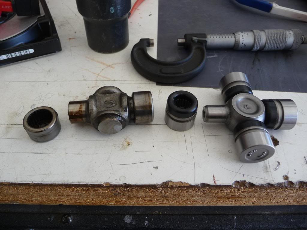

Well.....appears the joke is really on me.....I just measured the cup diameters of the Precision Universal 392 ujoint and they are .002 smaller than than the original.  Needless to say, that is about the amount of the press fit so these cups just slide right through.
So, now back to the research, I thought the research had been done and the 392 joint was a fit but with the loose cups, it simply will not work,
I am sure I did not ream the ears oversize because the old cups are still a nice tight press fit....
So I have to ask the question....has anyone any knowledge of a 392 joint being actually installed and did the cups fit with a proper press fit.
The joint I bought comes in a box labeled Precision Universal, the joint is actually made by GMB in Japan.....this statement is simply a point of reference.
I found the below dimensions while searching for info and they are very misleading and not to be relied on either.........so crap......
outside to outside of c-clips is 1.62" three days from purchase to my front door $20.00 each free shipping!  cooldude
cap dia. 0.79 ,  overall cap to cap outside 2.337"=
SO IF ANYONE IS USING ONE OF THE REBUILT UNIVERSALS WITH OUT THE CUPS BEING PRESS FIT AND ONLY RETAINED BY THE CCLIPS.......REMOVE IT IMMEDIATELY OR YOU WILL DIE!!!!!!!!!!
Also take a look at the picture of the 392 compared to the original.....it ain't as beefy!!!!!!!

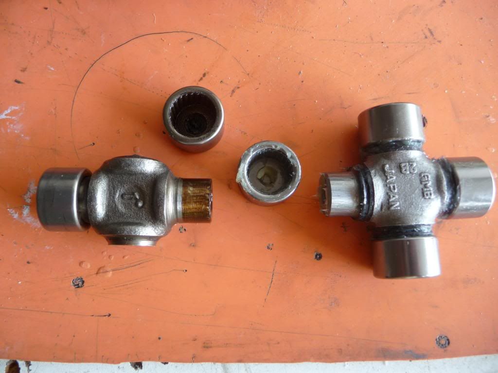

WELL-WELL-WELL........I think I am beginning to understand.
It appears the original ujoint bearing cups are what is known as "drawn cup needle bearings", these cups have a thin wall sheet metal housing.  They are designed for high loads and are of good quality.
The dimension of the bearing is oversize for the bore it is to live in and is intentionally shrunk upon installation to fit.  The bore it fits into is dimensionally the same as a ground cup bearing (in our case .788) with a shrink fit of .790........thus a .002 interference fit.  A standard ground cup bearing will essentially pass right through the ear bore of .788 because it is .788 also....thus no interference fit.  I suspect this is the reason the rebuilder in Redding had such a hard time finding "good" yokes, ground bearing cups simply passed through with no interference.
So the challenge then is to find a ujoint of proper dimensions with drawn cup needle bearings and they will fit our yokes just fine.....will have a nice interference fit and life is good.
So the question is, where do we get such a joint.........buy it from the same vendor Honda does if that can be identified, or buy a ujoint from Honda, remove the joint and bearings and install in our good yoke......or....ya ready......just use the part from Honda and be done with it......
So....it looks like I am done with this project unless we can identify a source of the proper ujoint with bearings .....
AND to think I cratered a reasonably good ujoint to find this out.....crap  tickedoff tickedoff

AT THIS POINT I AM PUTTING THIS PROJECT ON A EXTENDED HOLD DUE TO THE NEW UJOINT NOT BEING AS A GOOD A FIT AS I FIRST THOUGHT.
THIS PROJECT DATA SHOULD NOT NOT.....REPEAT NOT  BE USED BY ANONE IN AN ATTEMPT TO USE THE PARTS MENTIONED TO REBUILD A JOINT AND INSTALL IT IN THEIR MOTORCYCLE.
IF YOU NEED A UJOINT, I WOULD RECOMMEND BUYING A NEW ONE FROM HONDA...OR OTHER PARTS SUPPLIER.

Yeah....thought this cross piece was going to work, but the cup o.d. of .790 just doesn't give enough press fit to firmly grasp the cup in the yoke ear.  It really need to be .791 to make a nice press fit and that essentially means that the Honda source needs to be found and tapped as a supplier for this to work. Centering and re-staking does not seem to be a insurmountable obstacle.....but the press fit just ain't working.... just one lousy .001 inch tickedoff tickedoff tickedoff tickedoff
For a c-clip version to work nicely, the lock dimension of about 1.450 with a cup of .791 would just be wonderful. Could easily machine or grind a flat on the inside of the ears and a nice press fit from the .791 cup diameter would make a solid unit...... Sad Angry
I suspect the bores in the ears might even stretch over time (this yoke is pretty soft) by .001-.0015 making it even more necessary to find a .791 cup.....rats!
