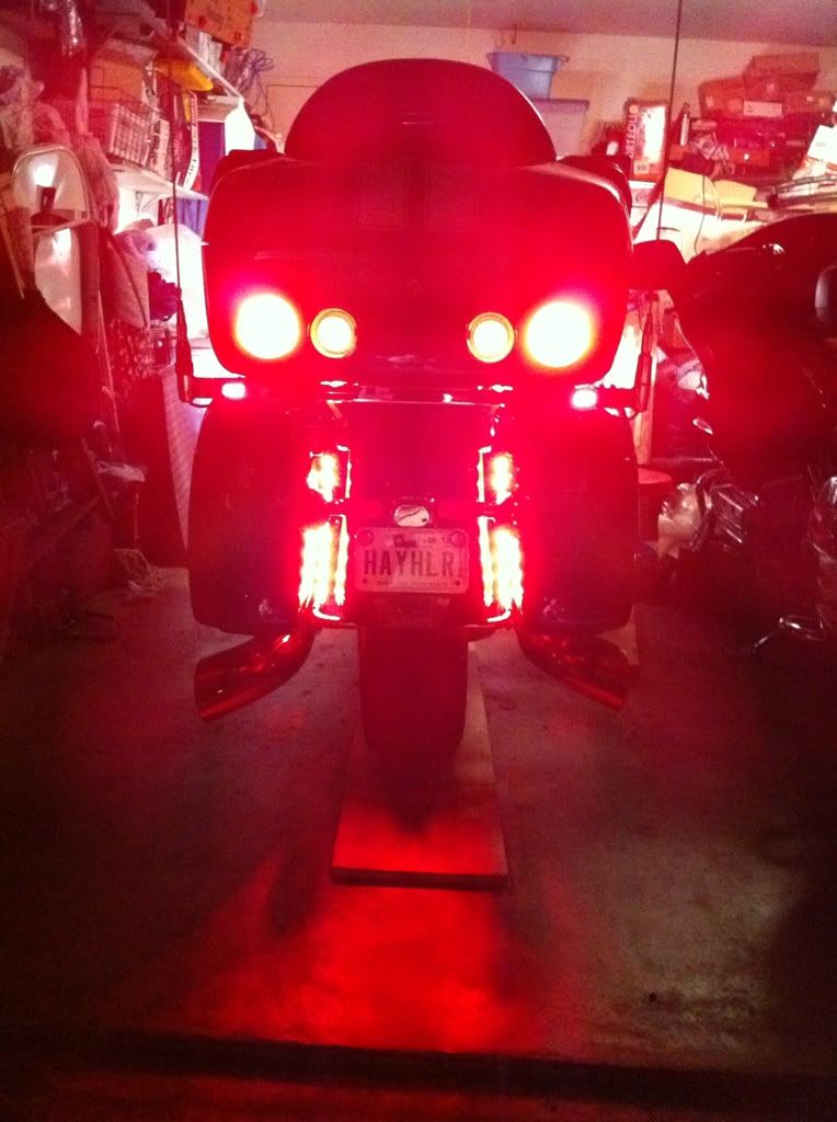

« Reply #12 on: October 09, 2013, 09:47:06 AM »
http://www.autozone.com/autozone/accessories/Alpena-24-in-MaxLED-light/_/N-25cd?itemIdentifier=327398&_requestid=1222712
I used a set of these (but in RED not Fushia) applied to the saddlebag mounts between the fender and the saddle bags.  I wired them into the brake light circuit, so they only come on when the brakes are applied.  So, the space between the fender and bags is dark until the brake is applied, then these triple bright red LEDs come on with the other brake lights on the IS trunk.
Really pops and gets the driver's attention behind me.
I have been told that the rear blinkers are somewhat washed out when the brakes are applied, so I usually turn on the turn signal well before applying the brakes.
Hay  Cool

« Reply #14 on: October 09, 2013, 06:30:57 PM »
Here is what mine look like at night.  The voids in the led's are the stems for the turn signals.  The lights really reflect off of the fender and bags.
