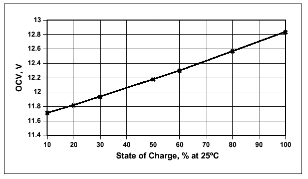

« Reply #9 on: October 30, 2013, 07:28:49 AM »
Chart will indicate quality of your battery charge.

« Reply #10 on: October 30, 2013, 07:41:12 AM »
25º C  same as  77º F
