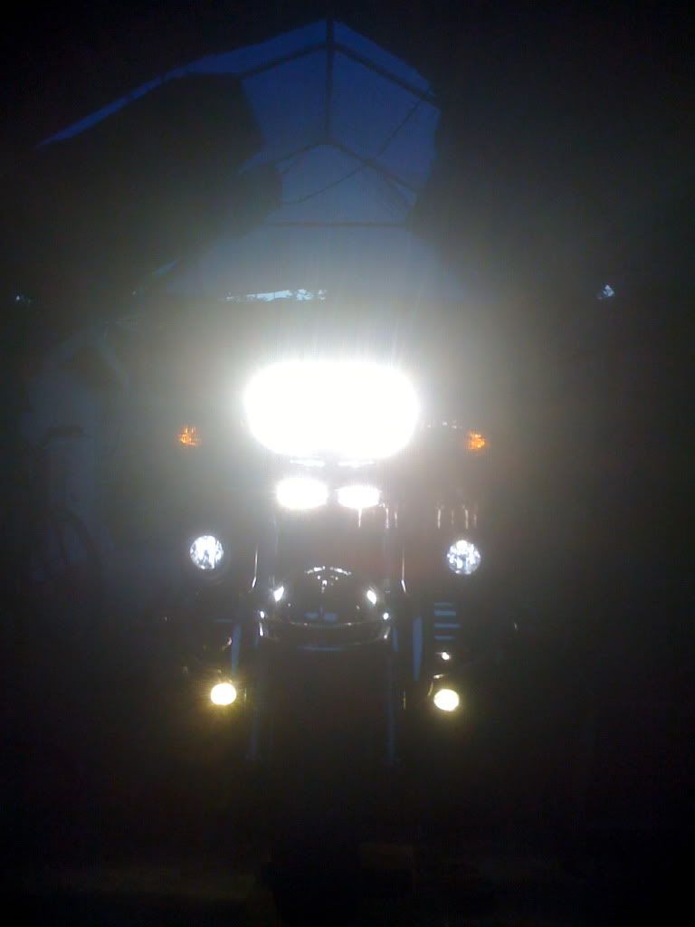

Here is a comparison between the Piaa head lights and an HID upgrade install.
The Piaa is the one on the right side of the picture the more white looking one.
And as a comparison here is a shot with just the Piaa's installed.
Keep in mind the pod lights are also Piaa bulbs and the extra set directly below the headlights are some el cheapo 35W or maybe 55W bulbs from Walmart.
here is another angle.
