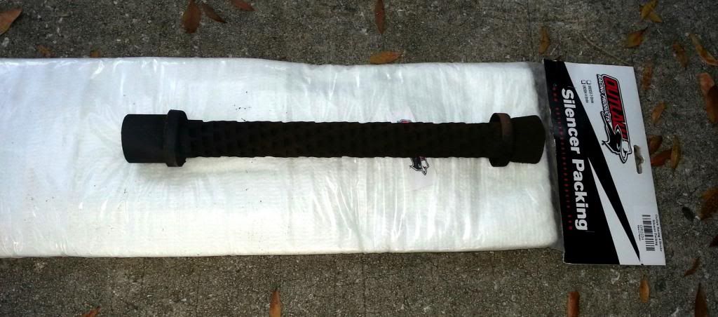

Started wrapping my baffles this evening.  Only got four of the six done before it got to dark to work.  I'll do the last two baffles in the morning.  I did start it up with only four done and it already sounds better "to me!"  Depending on how long this wrap last, I'll get some SS screen  to wrap around the matting to slow deterioration of the matting.

Finished up this morning, with the wrap, and all I can say is "Wow!"  It is so mellow and not that over powering loud noise.  She is still sounding good without all the overkill annoying noise.  I really like it.
The baffles were a nice brown color instead of the feared black carbon color.  That being said, on the very ends of the baffles, it was black carbon colored.
