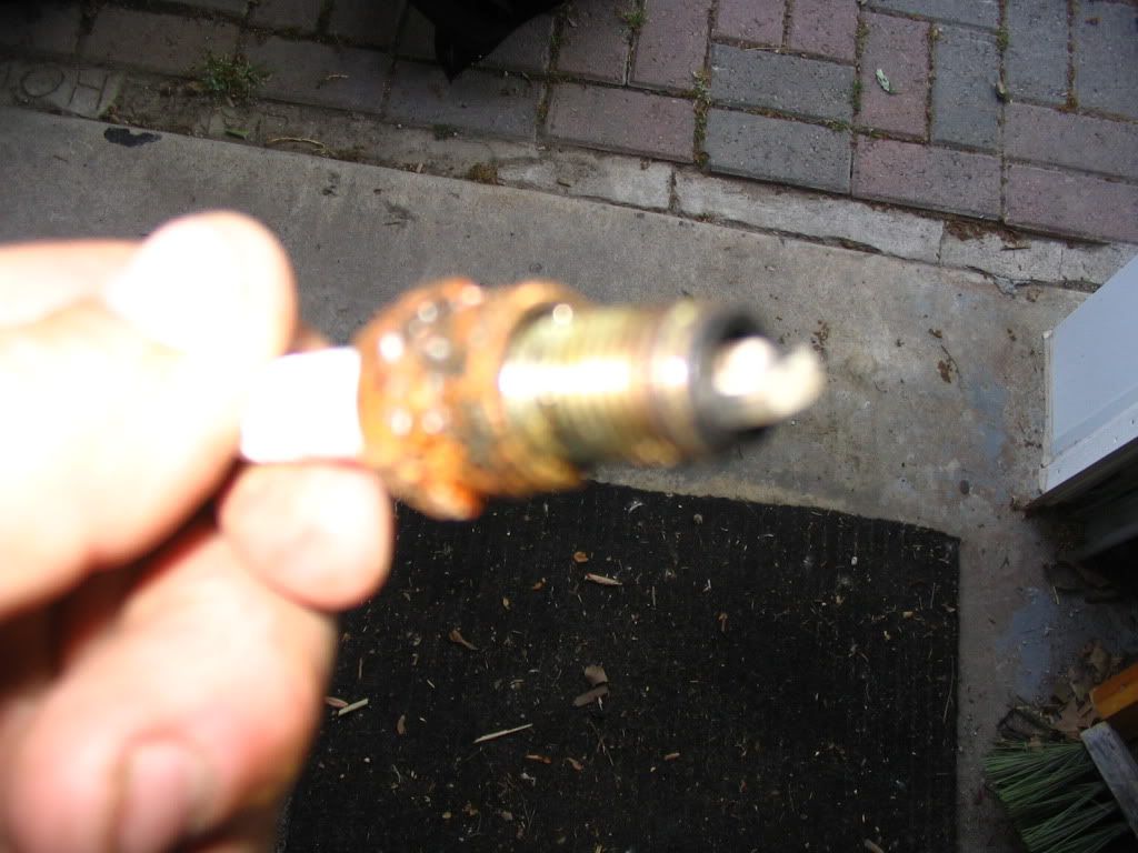

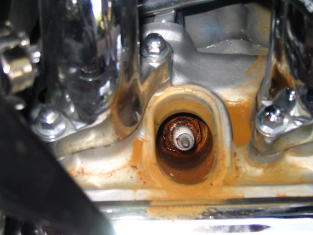

Hi Slider. If you don't do what Fl suggests ,this will happen.
Water filled the spark plug hole and the plug rusted out. Bike ran well but got orange water on my pant leg. Do what Fl says and all will be well.
