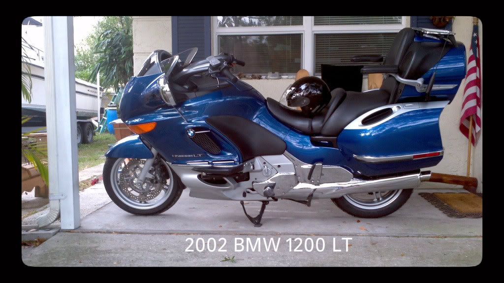

I spent most of the day working on my Beemer.  Had to replace the front brakes lines.  It really tough working on a Beemer because everything is under the Tupperware fairings.  Before I put it back on I have to fix some cracks and splits.

I'll see,,,, yer ''tupperware'' n' raise ya,,,, 1   2funny
