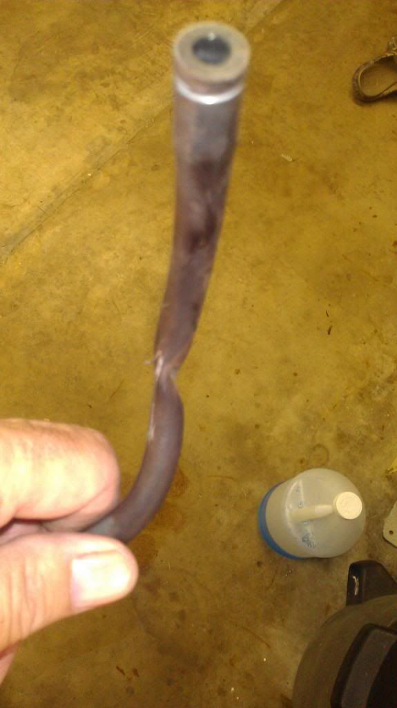

Putting on my fancy smancy radiator grill a few days ago, I noticed the tube hard and kinked /pinched so I replaced it. Easy on a 2001 I.S. you will need about 4 ft. of hose,(only use about 3ft), a new shifter pedal rubber cover, new air filter, and some chrome polish. Remove the side covers and gas tank, and plastic neck cover, r/h side...Finesse, the tube off the radiator with lots of finesse, and be careful there ....(the kink obviously at the top of the radiator/frame) we can always use a new shifter pedal rubber and air filter,,right...
the offended tube .
the offending crevasse
The tube just clips in with the main wire harness.
