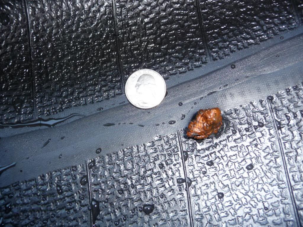

This will be my 3rd P4 and will post a picture of the two plugs from the inside of the tire.  I can't break the bead loose to get the damaged tire off.  I took the last one to a goldwing mc shop and their machine would not break the bead so I had to take it to a car tire place.....heavier bead breaking machines.  My new P4 will be the day after Christmas....dang....hate being grounded!!!

VULCANIZE that tire ------that is a hot patch on the inside---it will work----GOD BLESS

Finally got some time today to get the P4 swapped, have a little country motorcycle shop that will do the deed. Pictured below are the two plugs from the inside of the tire with a quarter alongside for reference.......

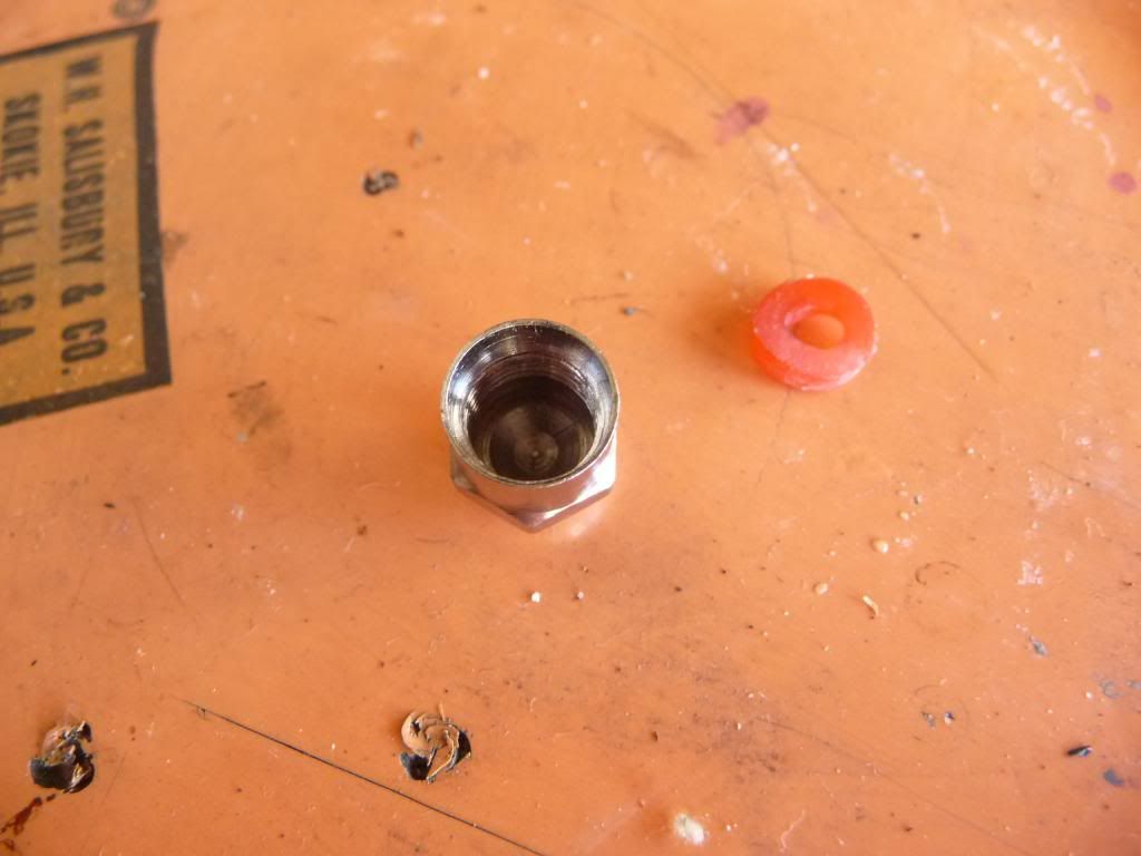

While doing the tire swap, I had a metal valve stem installed that I got from some recommendation on this list....I think it cost about $2.50 each. The thing I wanted to mention is, I got the tire home and checked the tire pressure before putting the tire under the bike.   It had exactly ZERO psi....I watched the guy fill it and he asked what pressure I wanted, told him 42 and and he topped it off and screwed on the valve stem cap....... crazy2 crazy2 crazy2 crazy2
So I filled the tire to 42 again and listened for any  air escaping.....none I could hear.....very strange.  Maybe I did not really see him air the tire up and I hallucinated..... 2funny 2funny 2funny 2funny
So, I screwed the valve cap on the stem and began to hear a hiss......WTH!!!!
Looked inside the valve cap and noticed a little pink o-ring that seemed to be pinched sideways.  Looked closer and noticed that as the cap was screwed on, the center portion of this pinched up 0-ring would depress the valve stem center and let the air out tickedoff tickedoff tickedoff tickedoff
The reason for mentioning this, this stem is a common one recommended on this list (and it is a well made quality stem).......if you use it, be sure to inspect the placement of the o-ring or simply remove it altogether....it is intended to seal any slight valve core leak (I guess) or maybe to prevent any water  intrusion........if I had not hear the hiss upon screwing this cap on, I could have chased a leaky tire for a while...

Glad you caught it.  I think I would take an ice pick and poke the little seal back up in the cap.  It might save you a slow leak in the future.

I'd just through the little bastard away and get a new one out of the box.
Oh, I fur getted, we keep a box or 2 of them around all the time.   Okay, I bad on that.
But I'd still toss it and get a new one.

It is just a matter of putting the 0-ring back in its proper place.....I did check the 3 spares I have and they are OK..not my day to go to Reno, pulled one out of four out of the parts bin and it was the duffed one....
