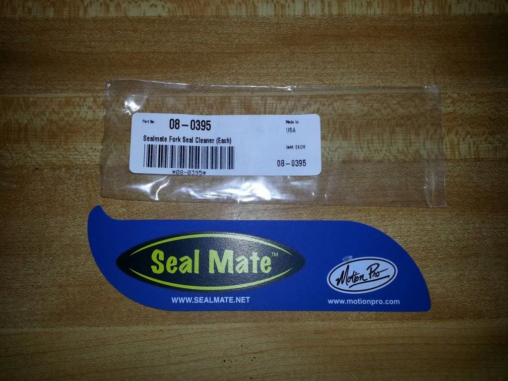

« Reply #14 on: January 15, 2014, 07:58:54 AM »
My "Seal Mate" fork seal cleaner came in this morning.   When it warms up a little later this afternoon I'll give it a try and see if it will work for me.  Just hope that my seal isn't bad and just needs the cleaning.    ($5 tool and & $7 shipping!  They could have stuck it in an envelope and mailed it for .44 cents.)

my best results where by removing the fender so I had 360 degree cleaning access. the dirt/crud was in a bad spot I suppose cause the first time i did it the leak worsened. after re-doing with the fender removed it hasn't leaked for 15k miles.
I also every few wks now wipe down the exposed fork with a soft cloth.

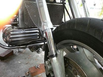

« Reply #18 on: January 15, 2014, 12:14:33 PM »
I took the fender off and did the leaking right side seven sets of 3 revolutions.  I could not tell if any dirt was pulled out or not from the residue left on the rag.   The jury is still out on wheather it's going to do any good though.  Even after cleaning the tube, just inside, there seems to be a very small amount of oil showing up.  Don't know if it's just residue oil that I couldn't get with the rag or not.  "Butt" it's definetly done some good.   I'll keep everyone updated.
I also did the left side since I did the right.

I changed  my Fork Seals today and found a Few Spots of Corrosion on the lower Fork Tubes, I cleaned then with 1500 grit Sandpaper. I also noticed that the Seals had a couple of Scratches where they had made contact with the  Corrosion. New Seals and New Oil, Now If they'll Last Another 15 Years  I'll Be Happy,Happy.Happy.

I put the dust seals back on and took a few miles ride and came home and parked her.   Checked a few hours later and no leaks as of yet.  Gotta check the manual about the fork oil and see what and how that's done.
