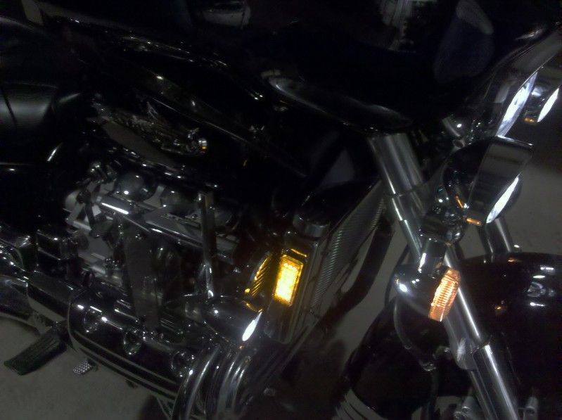

« Reply #5 on: January 07, 2014, 03:47:47 PM »
They're stuck on with double sided tape.
I replaced mine with these......
http://www.bigbikeparts.com/templates/product.aspx?ProductGuid=16-117A&GroupGuid=291#16-117AGallery[pp_gal]/0/
