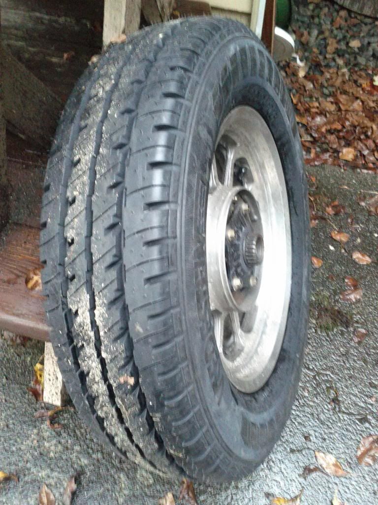

Have you considered the Vredestein Sportrac 3? My first CT was the GYTT. Though I never complained about it I often wondered what the square shoulders were doing to my handling. Found out it affected my low speed handling.
The Vredestein literally has a rounded profile. I have 6k on this tire and have found the handling much, much better than the GYTT.
http://www.tiresbyweb.com/p-9409-vredestein-sportrac-3-tires.aspx
Had a fellow VRCC member introduce me to this tire and was happy he did, so I am doing the same here.

Well, you've got that tire on backwards!
2000_Valkyrie_Interstate
DarkSideR
Posts: 1795
Pueblo, Colorado
« Reply #12 on: January 17, 2014, 09:27:14 AM »
You are correct. I have since corrected this. Had a small HD custom shop mount it so.. expected. So don't let that detour you. The picture was posted is illustrate the shape of the tire.

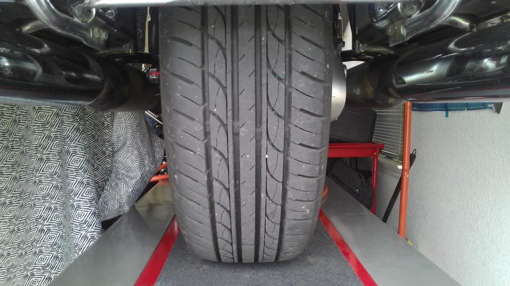

  Hey Oleman , I have had great luck with my 205 -55 -16 Michelin Pilot from Sam's Whse. for $135  ....  It has a plain jane passenger car tread design that's not aggressive in design so my rear end doesn't do the two step  on odd ball surfaces and it stops on a dime if need be  , and great in the rain  & wet streets  ......  I've got about 34,000 miles on the clock so far and wondering if its ever gonna ever wear out after 4 yrs. ..... One thing I took in consideration when buying tire , I did not need a tire with a High Speed rating , because the side walls won't flex as easily in tight turns , my tire's sidewalls do flex easy for tight turning especially like in a cul-de-sac  if need be  ......  But when it does finally wear out ,  I'll be switching to a 60 series instead  ....  Thanks the Geezer  crazy2

It's my opinion that the use of a unidirectional tire vs a bidirectional tire is mostly one of aesthetics.  The only caveat to this is that the higher-performance tires that many prefer to use are more likely to be unidirectional.
Symmetrical vs. non-symmetrical is another issue.  If the tread pattern or rubber compound is such that the bike will feel different or have different traction in a left turn vs. a right turn, I would avoid that tire.  An example:
If it's non-symmetrical in such a way that the right side is the same as the left, but rotated 180°, the tread shouldn't be a problem:
All this being said, I prefer the aesthetics of a unidirectional symmetrical tire:
