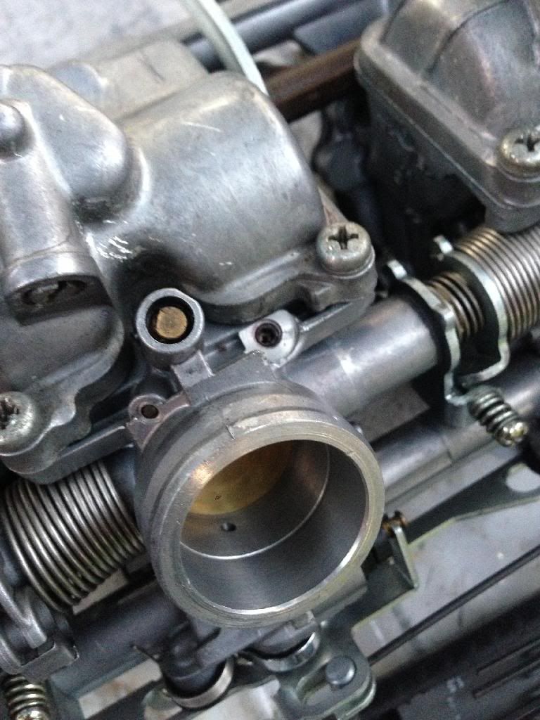

what I really need to know is this;
 i have taken the carbs off and rebuilt them and while they were out I did the de-smog and just used vacuum plugs on all the carbs.  I also plugged 5 of the intake runners and plan on running a hose from the petcock to runner # 6,   but on the # 3 carb there are 2 ports and I'm not sure what to do with  the bottom port.  Does it get plugged or does a hose need to be on it and if so where does the other end of the hose go?  I installed a crankcase breather filter on the diaphram that has the 2 #6 hoses going to the top vent rail on each carb bank but there is a small port on the diaphram also do I just plug that too?  I have asked this several times on several different posts and haven't gotten any results so I was thinking that if I could post pictures of what I am asking than maybe someone would understand what I am asking.

« Reply #6 on: January 16, 2014, 08:56:58 AM »
With a desmog, there is nothing on the carburetors that need attention (or anything done to them).
The intake runners need the hose barbs capped off, with the exception for a stock petcock.
You are trying to do something (whatever that is) to the carburetors that is not correct.

« Reply #7 on: January 16, 2014, 09:07:40 AM »
"IF" you have a California bike (charcoal canister under the swing arm), during a desmog, you need to unscrew the nipple on the bottom of #3 carb and put a set screw in it to plug the hole.
I had a picture of the port on the bottom of #3 somewhere, but can't seem to find it now.
EDIT - Found it.  The set screw is just to the right of the Pilot Screw in this picture.
<\EDIT>

Only if you are going to de-smog the bike.  That line should run to the canister under the bike when stock.
AtticRat schooled me on that one...  Smiley

Ricky the reason that I am plugging the carbs is because after I replaced all 6 Vacuum hoses that come off the 6 way T it said to PLUG this tube.   So I figured that if it wanted me to plug the T then I would just remove the vacuum hoses and plug the carbs. Talk about cleaning up the valley.   I did replace the 6 drain hoses and they are the only hoses still under there.   I also bought a new hose to run from the #6 intake runner to go back to the petcock.
Hayhauler I did not know that I had a California bike so Thank you I was starting to wonder if I just didn't understand what I was talking about 2funny  Also does that mean that I can't just cap it off?

 I understand now that I re-read your comment UNSCREW (key word )
will do that instead of rubber cap.  uglystupid2

Being unfamiliar with the California carburetors, all I will say is that those are vents that are meant to route the vapors from the gasoline to the canister as the California law dictates.
Being a vent, it doesn't matter whether you plug them, or not, but I would just leave them alone because any other method of venting may not be available since they are California edition, and they definitely do not need a vacuum on them.
