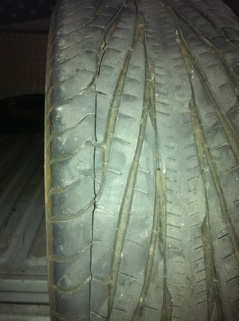

This tire didn't fail while out on the road, I noticed it in the garage.  This is a GY Triple Tread that has about 14.5k miles on it.  It was sitting in the dealership for 4 months on the sidestand while the paint was getting done.  This crack went about 1/3 of the way around the tire.
I don't know if sitting for an extended length of time on the sidestand caused this crack, or if it was this way when I dropped it off, but I didn't want to ride it 45 miles home, so I swapped it out with my spare rim with the MT tire on it.  I rode this tire from Houston, through Colorado, up through South Dakota, and over to IZ in Michigan.  I rode it home and around town for a while until I could schedule the paint work at the dealership.
I replaced it with a Falken Ziex 512 in 205/65/16 size and never looked back.

Hay, that is the only defect in any GATT I've ever seen or read about.
That said, I would not ride on it either.
Both my interstates have them, and are out on the sidestands not getting much riding time in Winter.
I always look my tires over..... it's only the single biggest safety issue there is on any motorcycle.

Wow... and it was still holding air?  How old is the tire?  What was the born on date?
In any event.... I would have to provide that to Goodyear for them to evaluate, and not let them even know what vehicle it came off of.  Obviously a defect of the tire and not a vehicle IMO.

The tire was 18 months old with the 14.5k on it.  It rode the Dragon the first year then the eound about trip to MI.  I don't know what the born on date was on it.
I caught it before bringing it home from the dealer where I had it painted.  I had them swap back to my spare MT and rode her home.
Just be sure and check your tires before every ride.  You just might find something like I did.
I don't run my tires down that far anymore.  I have 3 of the Falkens in the garage and will change them out every year, regardless of the miles.  Should be somewhere around 15-20k this year.
I ran 40-42 lbs. in it all the time.

Its probably just the photo, but the tread appears to be scalloped and the sipes seem to be feathered a bit, suggesting it has been run at low pressure for an extended time....

I don't know about that but it looks to me also that the tread is breaking right at the line where the steel belt edge is, or pretty close anyway.
That would make me think a poor quality lamination. A manufacturing weakness.
The radial belts are the only thing holding the tire together. And inflated (I guess).
I agree Ricky.  It looks like it split where the steel belts end and the sidewall starts.  It held air just fine, I just didn't feel like taking a chance on it for the 40-45 mile ride home...
I guess I should have cut it up to find out what was going on with it...
