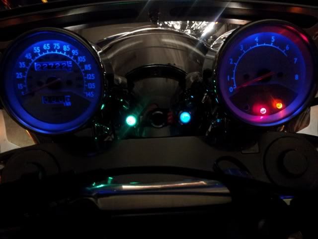

Hey guys,   wondering if anyone knows what kind of lighting source is in the spedo and tach......  LED, bulbs or what...  I want to get more light in there. Anyone brightened them up??

The original bulbs are about 2.5 watts
replacements;
158  3.3w
161   2.7w
194  3.8w
168   4.9w
I like the #158 or #194

I have the cool white x5 bulbs in my guages.

Plus 1 on the LED's

Superbribht LEDs. Bluex5 shown below.

Just ordered two of the wled-cw5 in cool white......  never have to think "I just dont like the lighting in those gauges"  again....    You guys have been here every time!!!

Cool White x5 here...Love 'em One of the best and cheapest functional improvements I've made.
