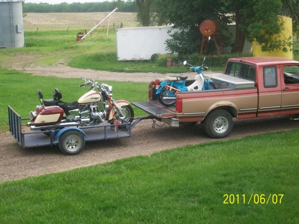

I have a golf cart trailer, low clearance, drive up ramp, light weight.  I think one could squeeze two on it. 2000 lb capacity, pulls great.  Have used it more for a utility trailer than bikes.  Hoser
http://i617.photobucket.com/albums/tt259/jrlord/family/100_0976-1.jpg
« Last Edit: January 26, 2014, 04:55:51 PM by Hoser » Logged

I have a "Big Tex" 14 foot trailer that will haul 2 bikes ....staggered    with a big lift gate     the Ride Texas magazine has an add for a heavy duty wheel chock made in oklahoma- no need to compress the forks     the others look wimpy compared to it   you have to measure your front tire width to get the right size     watch you tube for all the screwups loading a motorcycle     the main one is the bike high centering with too sharp an angle on the ramps going onto the trailer   at a motor home/ trailer place get stone guard that slides onto the hitch     with heavy duty chock you really just need a very heavy duty strap around the back tire to keep it- the bike- from flying forward with an accident
