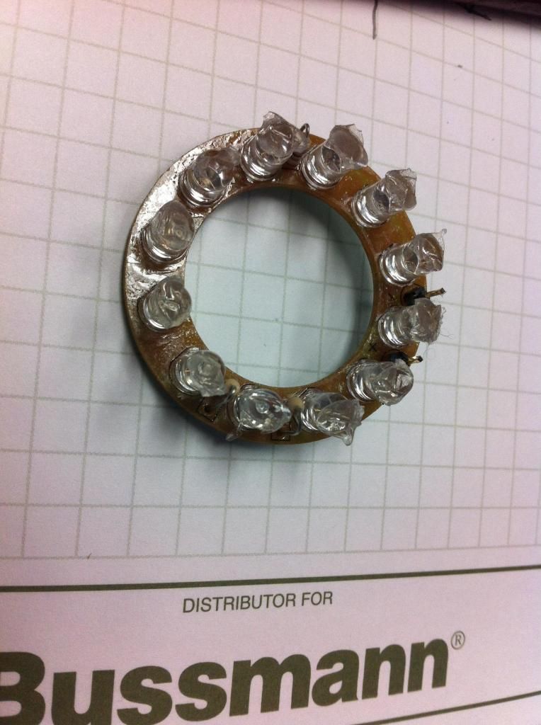

first off, who makes this?  I got a set of turn signal lights, and these were in them.  they were wired with diodes, and I didn't know why.  anyone know?  what I'm looking for is a schematic explaining other methods of wiring them up.  I'd like to have 'em set up so that when I push my brake and turn on the turn signal, the signal that's on turns off the brake light for that "ring".  (make sense?)

Electrical connection makes them.Had them in my std.but I went with custom dynanicshttp://www.customdynamics.com/motorcycle_dynamic_clusters.htm 48 leds for my tourer.super bright you'll really get noticed.
BW
« Reply #2 on: January 24, 2014, 02:23:53 PM »
Correct.  They're from Electrical Connection.
http://www.electricalconnection.com/docs/roadbike.PDF
http://www.electricalconnection.com/other-lighting/tsk-star&sport.htm
I have the install wiring diagram for them....somewhere.  Might take me awhile to find it though.  Sad
yeah, if you could find that I'd really appreciate it!!
thanks.
Posts: 5196
« Reply #7 on: January 24, 2014, 05:30:29 PM »
That's what this circuit does.  Inexpensive & reliable and I've been using it for a dozen years.
Explained in detail here:
http://www.horseapple.com/Valkyrie/Tech_Tips/VTX_signals/vtx_signals.html
