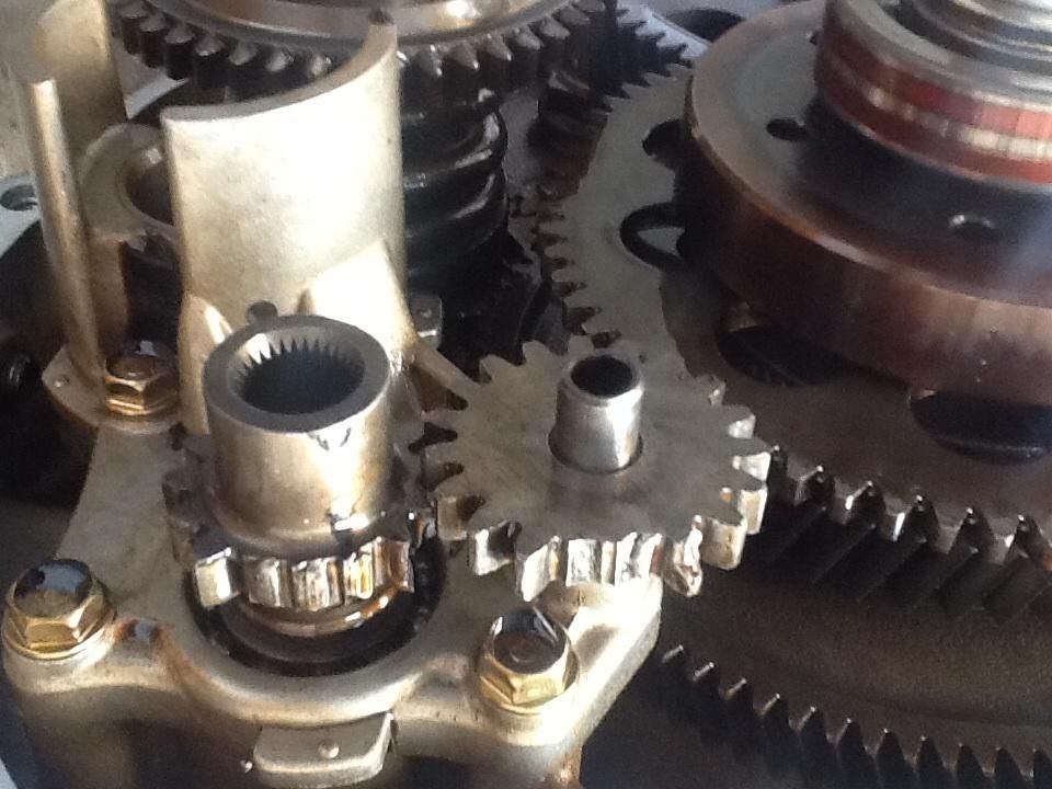

hey all, i just pulled apart a 98 i bought that was hydro damaged...if you need the sockets, i got them!! come on down with beer, and we will have it fixed up in a day...
heres some photos of my project...

http://s1333.photobucket.com/user/bitikofer72/library/
this should be all the photos of the teardown. now for tires, brakes, polish, gears, case, oils, carb and final drive clean, and the RIDE

yeah but the bike needed a teardown anyway. i pulled wheels, brakes, final drive, carbs, everything so just dropping the motor wasnt that big of a deal.  thanks to this board i knew exactly what i was getting in to!

someone asked my mileage the bike had 51000 but it had sat several years. the petcock failed, my best guess, in the past few months while the previous owner was trying to sell it. when the battery couldnt overpower the hydrolock, the jumped it off a 3/4 ton diesel truck. that really spun the starter!! he told me it was shortly after that the bike started making a clanking noise when running the starter, if it engaged at all.

thanks joevalk!! yeah it looks like someone had a good time riding a lot of seawall miles with a south breeze...i brushed the corrosion off and gonna ride like this till i find an affordable replacement. i am also going to replace the intake tubes and timing belt cover for the same reasons at the same time. poor thing is just gonna have to ride ugly for a minute while i save more money.

heres the photo gallery. i rode it the first time today. still need to tie up a few loose ends, like install the dks tire etc...but in two weeks i disassembled and rebuilt the cars, then did it again to fix a mistake, replaced the starter gears, welded the cracked case, replaced the brakes, rebuilt the clutch cylinders, bled all those fluids, oil and filter...will be redone in a few hundred miles...there was a lot of gear teeth in the case...got some of the peeling custom paint off the front fender, desmogged (government is inefficient...thus anything the government wants on an engine makes it inefficient....thus i remove it...) crankcase breather filter installed, of course a new manual petcock and fuel lines, and im sure theres more im missing. thank you wizard, and everyone else on this board...im sure my girlfriend thinks ive been looking at porn all hours of the night but ive really just been on here researching!! anyway it fired up this morning and we went for a spin. its gonna be a good summer!
