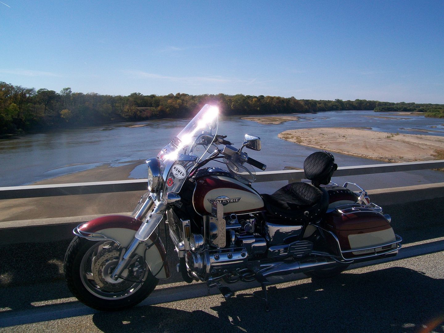

« Reply #29 on: February 03, 2014, 04:07:36 PM »
Here is a picture of the camel toe model.  Hoser   Grin
