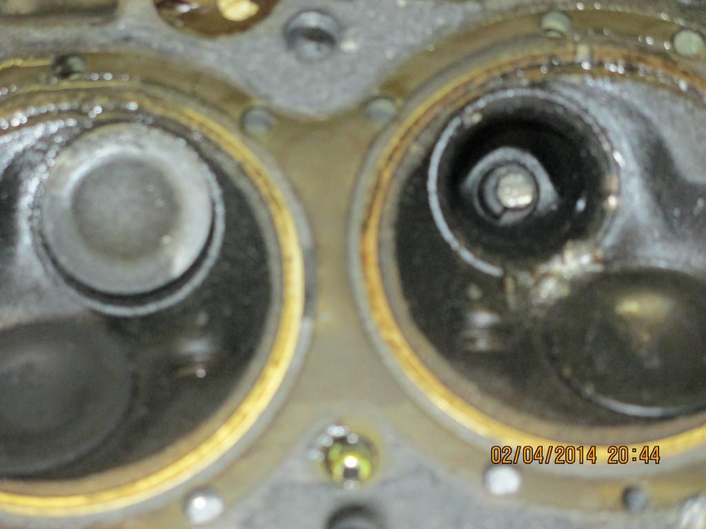

Jeff from Naples was even kind enough to bring it up from Ft. Myers with him when he and a friend came up for a gun show. I paid the recycler and told him Jeff was picking it up. My conversation with the recycler was "oh yeah, runs fine, no problem." Now that I'm getting ready to clean/paint the engine for installation, I decided I'll try turning it over by hand. It wouldn't, so I started looking and saw the left rear spark plug was crunched flat. My spirits sank, I pulled the head and sure enough....busted intake embedded in the piston. The adjacent cyl. also appears to have suffered a strike. Look at the pictures, the intake on that cyl. is not centered but is sitting on the valve seat. And the piston looks like it has a fresh shiney strike. Guess I should have checked the engine as soon as I got it instead of waiting a year until I was ready for it. Doubt the recycler will make good on it now and I don't blame him. I really don't want to get involved in an overhaul but can't afford to throw away the $$ I paid for it. With more than one possible strike like that it's entirely possible the crank has flat spots as well. Kinda sucks....big time.

Well crap John. That looks a lot like the one that came in the bike. I would at least appeal to the recycler you bought it from and explain it to him. He might be a stand up guy and make things right. Hopefully he didn't know it was blown up when he sold it to you. Worth a shot anyway. Would a rebuild be cheaper than finding another motor?

Look at the middle picture in the second row, you can see the flycut for the valve clearance in the top of the pistons. If it's just pistons, crank, and both halves of the case it would be a fair amount of work but switching everything over is doable. Still waiting for a response on that from Pinwall.
