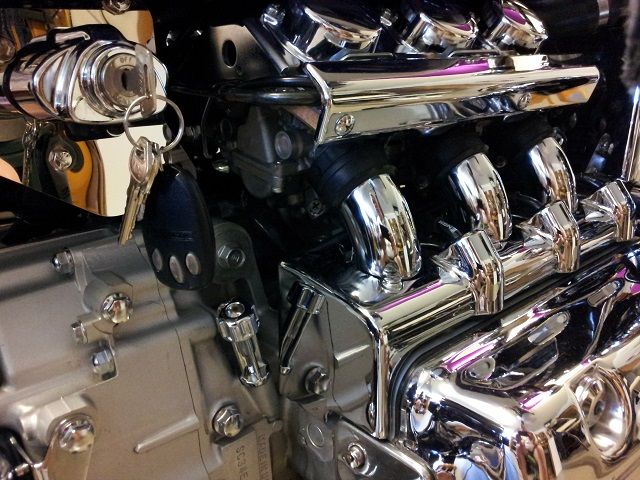

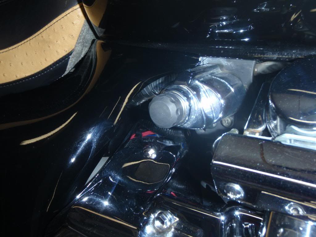

« Reply #12 on: February 07, 2014, 02:13:41 PM »
Ok, so I took the advice a couple of you guys gave me and here is how it turned out. Stock grip end slotted with the key cut down. Turned out pretty darn nice I think!

« Reply #20 on: February 08, 2014, 08:16:23 AM »
Wiggy, I took your advice and slowly filed the key down, checking it in both locations as I went until I had it just slightly above the key cover on the tank. I had been wanting to do this since last summer when I saw one done on a Tourer I was thinking about buying. Decided not to buy the Tourer, figured I would Super Valk my I/S. Haven't gotten around to it yet but, with the weather in Michigan I still have time!

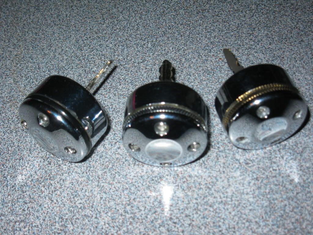

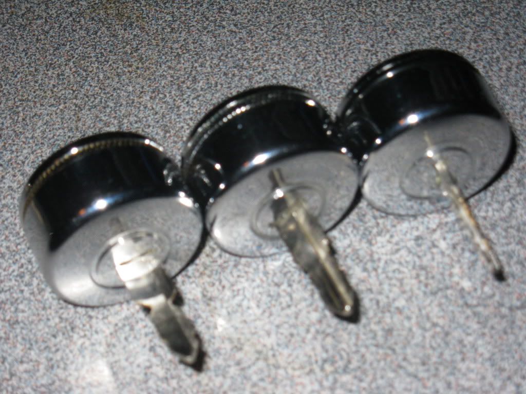

Chrome
Posts: 686
London Ontario Canada
« Reply #21 on: February 08, 2014, 08:28:26 AM »
3 Valkyries, 3 sets of keys, 3 different coloured rings.

72cutlassdude
Posts: 125
99 Super Valk VRCC 35563
Laingsburg, MI.
« Reply #22 on: February 08, 2014, 08:37:03 AM »
Chrome, those are cool! Look like a Kury grip end? Now I am looking for some sort of black knob to make one for my sister's Shadow Ace since she liked the way mine turned out.

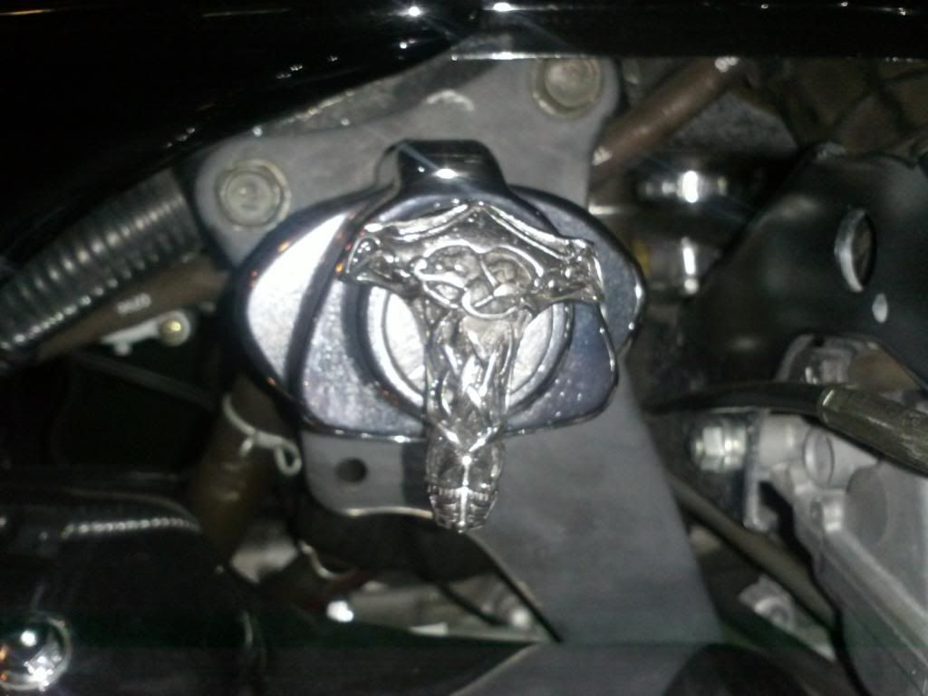

« Reply #26 on: April 25, 2014, 06:19:48 PM »
Keeping with the "Norse" theme, I used a Thor's hammer:

« Reply #28 on: April 26, 2014, 06:57:32 AM »
Nice touch Mapper!

Mapper
Posts: 390
Montclair, VA
« Reply #29 on: April 26, 2014, 12:57:10 PM »
Thanks!  I got some really good pointers from this thread and thought I'd give it a go.
