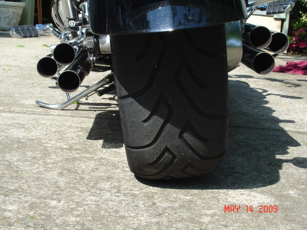

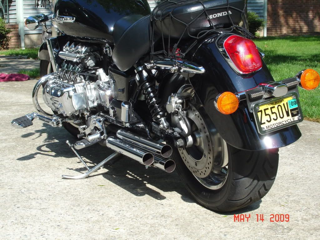

I changed over to a CT a few months back.  Im not a cornering guy, more straight liner but for a rounded  tire, check out the Yokohama A048.  Comes in two compounds.  Not cheap and wont get the mileage of some others but may be what you need.  CT definitely feels different at first, but Im used to it now.  No complaints, I love the solid feel.

I cant speak for all CTs, but my Yoko ADVAN A048 will go anywhere my bike tire would.  Dragging hard parts in the twisties..  Thats far enough.  No chicken strip left on the front tire.  Look up some pics of SmokinJoe.  There should be plenty.  The corners take a bit more counteersteer pressure, but once your used to the CT, you will ride it hard just like ya did your bike tire.  I cant say everyone will have the same impression as I, but I live in the NC mountains, and we have a curve or two around here.
I dont have any pics of me from Killboy or anyone, but I did dig one up of Joe on his CT.

That ADVAN is the most motorcycle lookin' car tire I think I've ever seen.  Looks like a contender for sure.
