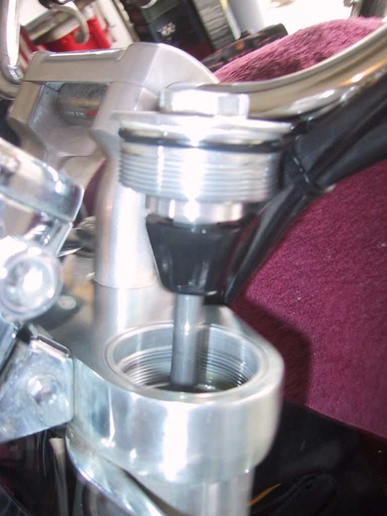

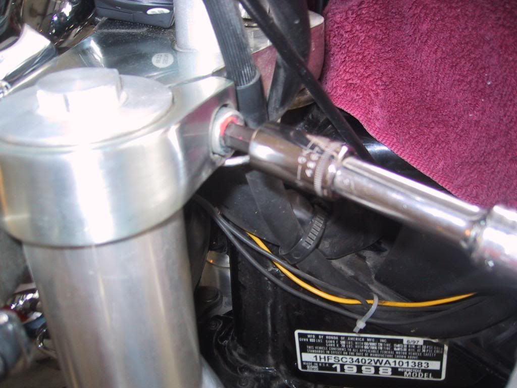

Undo pinch bolts at fork caps
Loosen fork caps until completely unthreaded

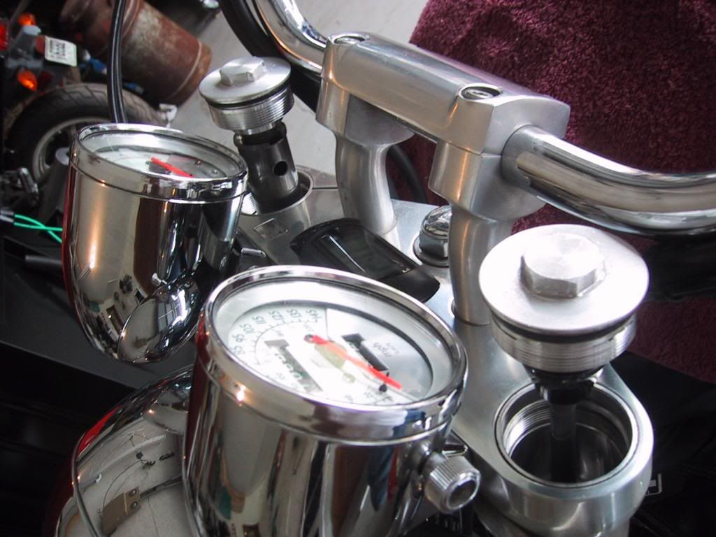

Raise front wheel so forks compress completely

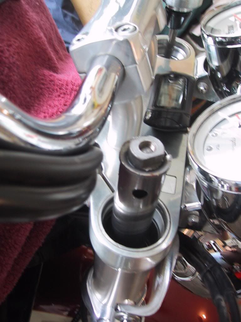

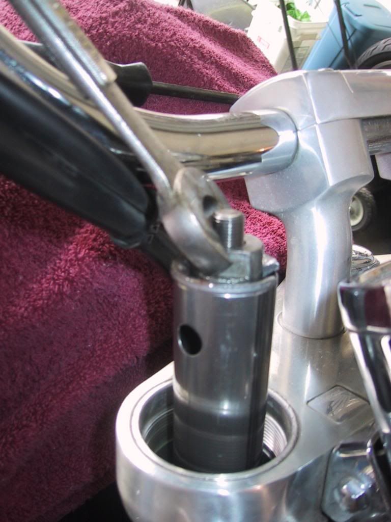

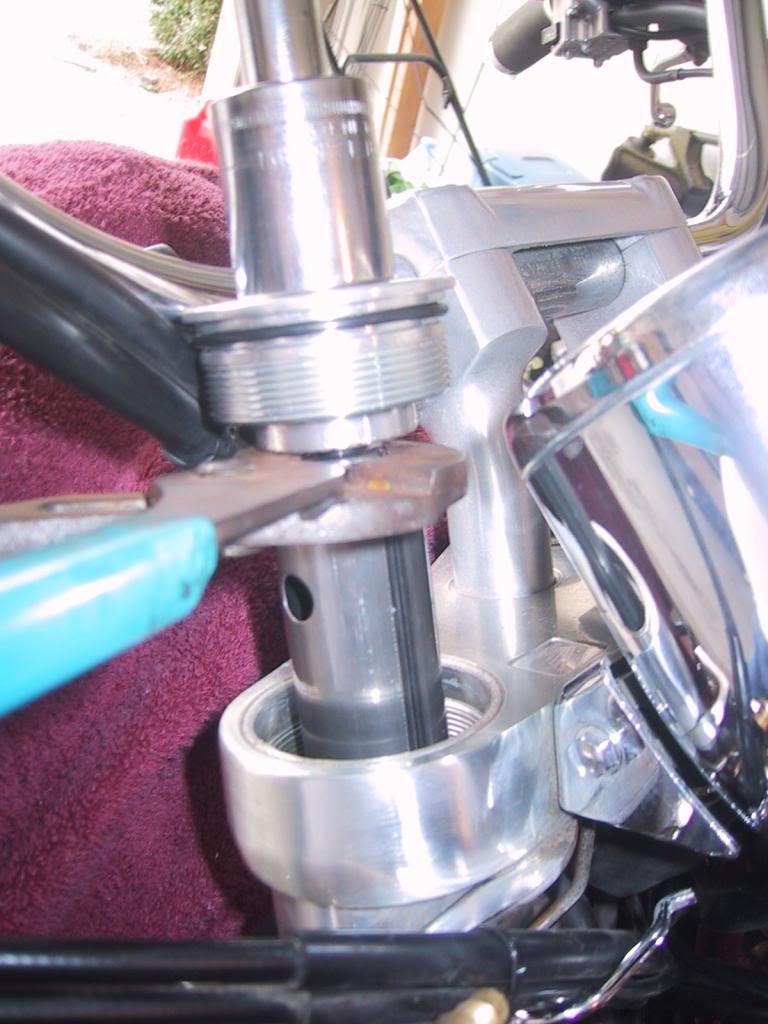

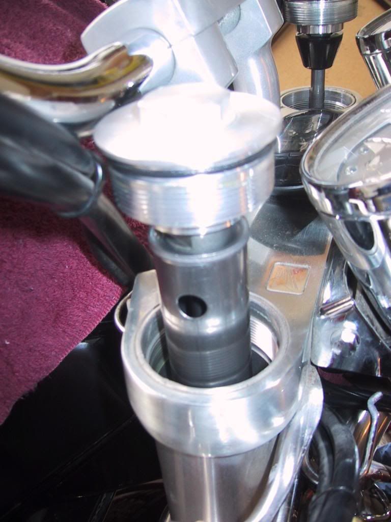

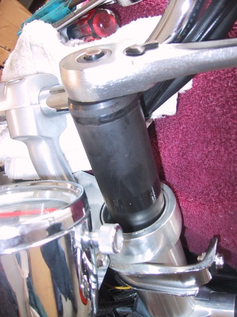

Remove right front fork cap. Have to try and grip the flat sided-round sided nut under the right fork cap. Photo 7. Can't use a wrench cause there are a couple of small flange parts sticking out. Hold this in place and undo fork cap.
Count threads exposed Photo 8
Undo flat sided-round sided nut about half way up the threaded portion

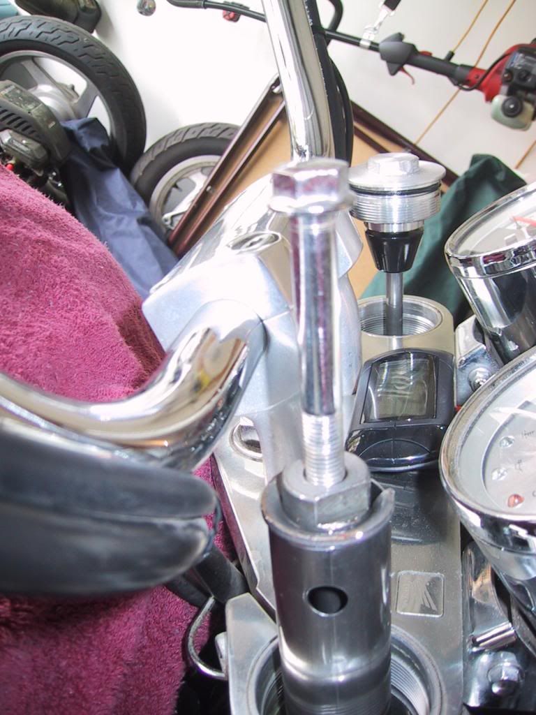

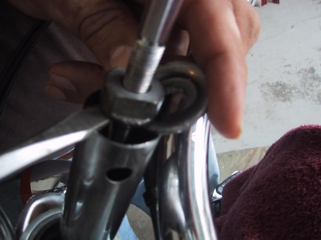

Thread bolt you have found in your workshop into hole
Make sure it's a good fit
Remove and wrap a coat hanger around it
Screw back in

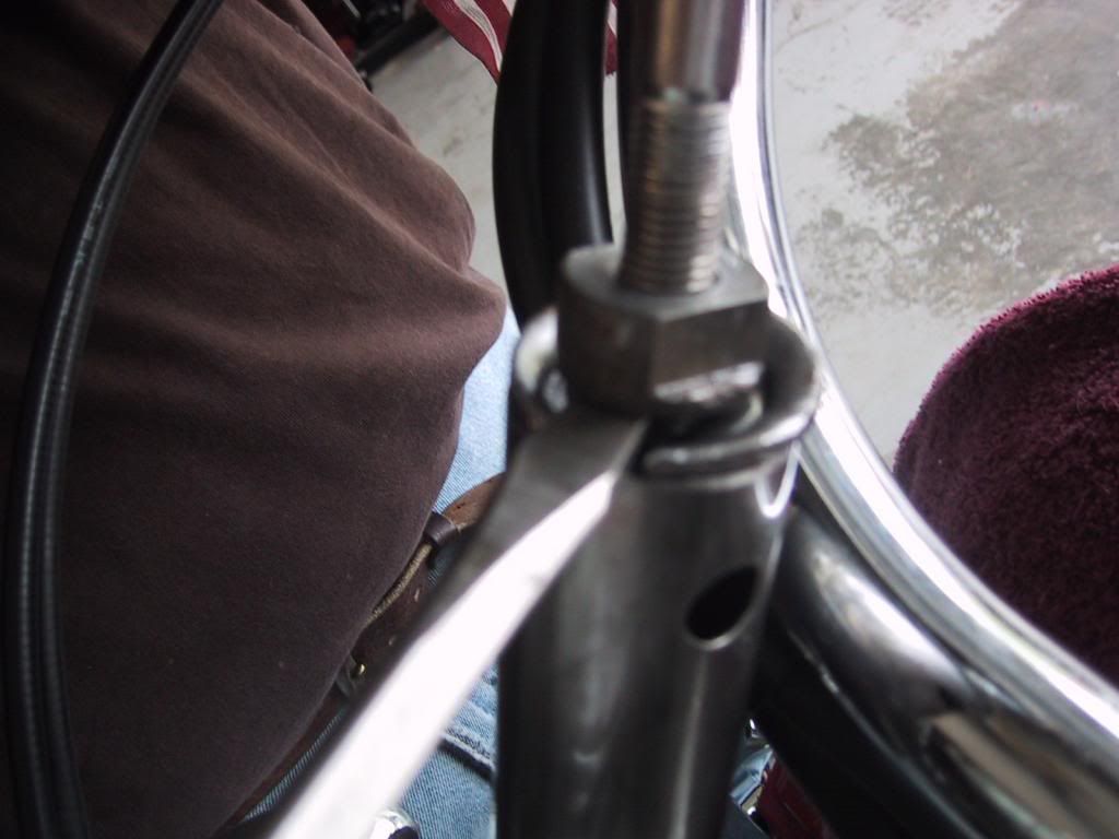

Using a flat bladed screwdriver prise the flat sided-round sided nut away from the tube below to remove collar Photo 13
Remove collar that has a slot in Photo 14
Slide the shiny bit in Photo 15 up over your bolt and coat hanger

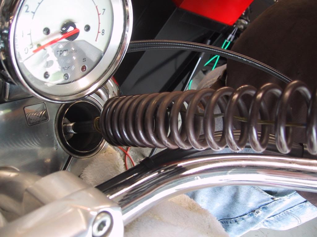

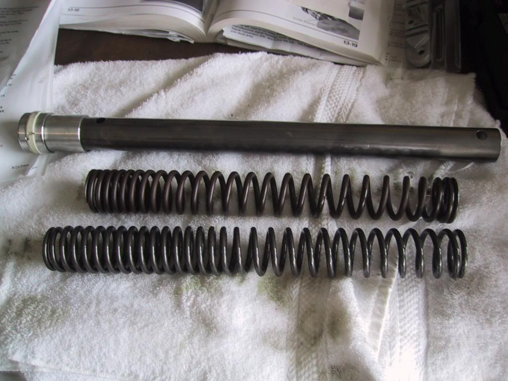

Now use another coat hanger with a slight hook on the end and fish down in the fork tube and remove the spring. SLOWLY to let the oil drain off. This is why you covered up in the beginning with towels/rags
Slide new spring back over

Slide shiny bit from Photo15 back over wire and bolt
Replace collar from Photo 13
Remove bolt you have found in your workshop and turn flat sided-round sided nut down until you get to the amount of threads you counted earlier

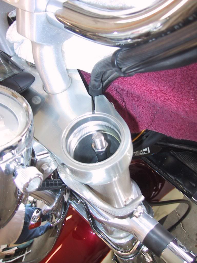

Left fork
Insert special tool and undo completely remove part in Photo 22
Hook out fork spring SLOWLY to let oil drain off. Washer comes with it.
Insert new spring AND then washer
Now using special tool screw part in Photo 22 back on.

Screw on fork caps. Tighten pinch bolts. Bounce forks a couple of times

Beautiful pics, Britman. Can I ask you a question? Do you happen to know the size and pitch of the bolt that you screwed into the
half backed off nut in the right tube?
Is it an 8x1.25 or a 10x1 or something else? I need to change out my springs to Progressives I bought. Did it on my first bike but can't remember now.
Anyone?
Thanks,
wiggy
