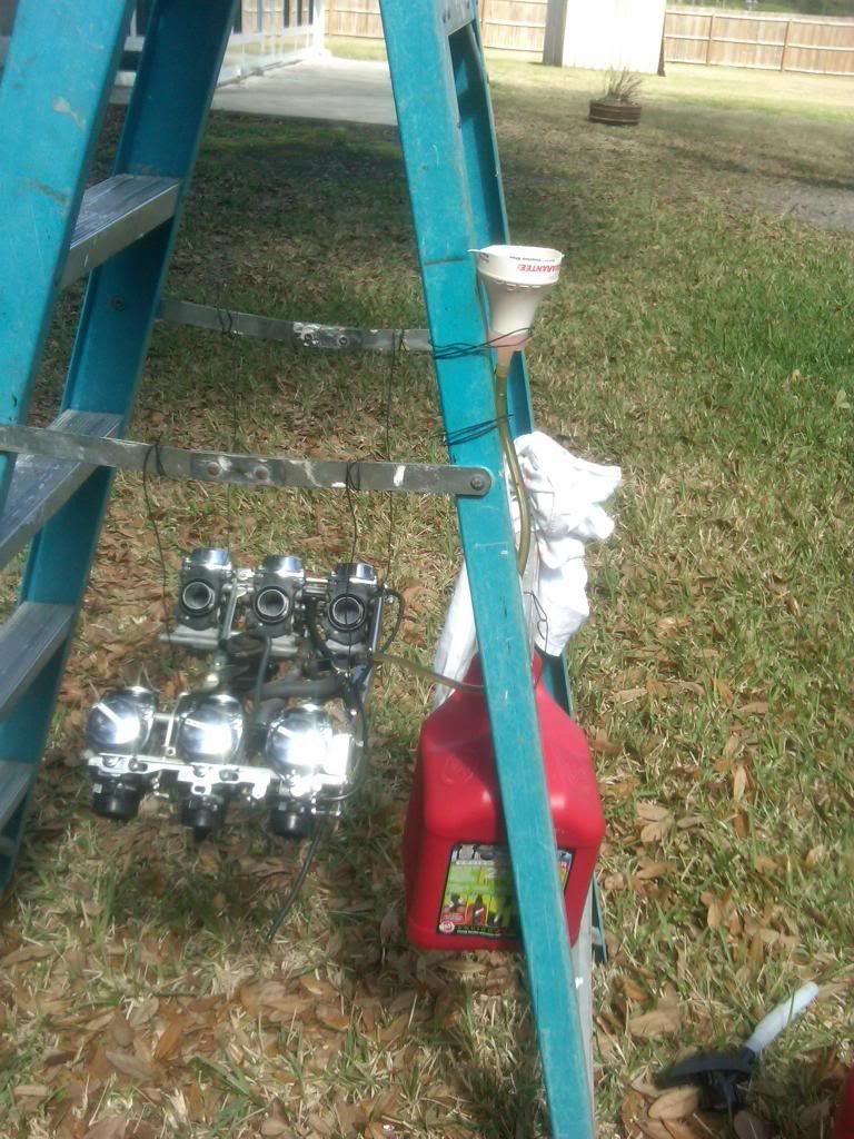

I just did my carbs last week and it's running great. Had idle issues that fuel cleaner wouldn't correct after several tries. Was apart for two weeks waiting on parts, and time to work on it. I bought new slow jets -35's (keihin) from jetsrus.com. I was going to put in 38's but changed my mind. (They are ready to go out -unused - to a member for a reasonable amount.) Didn't replace the bowl gaskets, they seemed ok. I sprayed carb cleaner in all the orifices most every night, and used compressed air. Put 12 paper bowls on the bench and kept everything together for each carb. Pre tested the carb rack by hanging it to check for leaks etc., prior to reinstallation in bike. Opened each drain screw and checked for gas filling bowls. Note; moved in new house so garage was/is somewhat disorganized..  Weather is great, heading down to Daytona Bike Week Wednesday!

Using the ladder was pretty clever!  cooldude

When I rebuilt my carbs last year I used the gas tank off the bike. I placed it up on a tool box with the carbs sitting in an old cookie sheet below it just as if everything was on the frame and motor. I let this set up stand for three days to make sure nothing leaked through. FYI, the OEM vacuum gas valve is no longer on the tank after I caught that POS leaking through.
