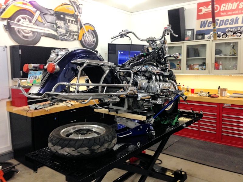

Not a HF lift table user, so I can't comment on that part of it. I did just get, and start using a Titan lift table recently.
As to the rear wheel removal, I did lift the back of the Valkyrie to get the tire off. I simply used a small HF aluminum 1.5 ton floor jack to lift it. Had the adapter on the Valk and used a 2x4 between the jack pad and the adapter. Solid as a rock; no problems at all with the tire change. In fact, I did it in about 1/2 the time it took when I used to have to crawl around on the ground to mount/dismount the wheel.

In most M/C magazines they have coupons for the HF lift tables for $299.00. Put two screw eyes on the front of the lift table so that you can secure the bike. Build a wooden lift adapter and use a screw jack to lift the rear off the table
 Save that $100.00 and get a Craftsman Motorcycle/ATF lift in addition to the lift table.

I think about 30ish inches on the height (thinking how high mine is, at work so I can't measure for you). It says in the advertisement.
Your talking about the foot operated one which is rated at 1000lbs (verses the air/hydraulic = 1200#) and the Valks are like 850lbs. It lifts but you know you have a heavy bike on it.
True dat.
My table came with U-bolts for this.
Or a screw jack and a 4X4X4 on the little cross member right behind the engine.  Front wheel clamped in, the rear comes right up.
I've had mine for a few years now and it's one of the best investments I've made for the bike.
I did change the little piddly front wheel clamp out to the "L" shaped one that comes on the air/hydraulic model.  Much safer IMO.
I've made a larger table top (3/4" plywood) for mine so I can put my riding mower on it too.  And when I'm not using it for the bike or mower I have a portable, height adjustable work bench.

I have the HF table and use their good wheel chock mounted to it. I walk the running bike right up on the table and into the chock. I am 6'3" so I can do this with little issue. Once in the chock the bike is sturdy verses using the POS vise clamp that comes with the table. I added extra u-bolts in the table for using ratchet straps to hold the bike up right and in place. Raising the bike is not a problem for this table. I strongly suggest using the long safety bar and lower the table to rest on it to relieve the pressure on the cylinder. Never trust a hydraulic jack with this kind of weight on it. I have heard of guys using homemade ramps along side this table. I must admit that I am considering this too as getting it out of the chock and off the table is a challenge for one 60 year old man. FYI, I use the lift adapter and a floor jack just like the previous picture shows. So far I trust this set-up and I bought my HF table used for $275. I also use the ATV/Motorcycle lift from Sears if I only plan to have the bike up for a short time. I have no problem buying the proper tools for the money that I save doing all my own work at today shop prices for kids that don't know these bikes.

Here's a thread with some links to other threads about the HF table lift and other table lifts.
http://www.valkyrieforum.com/bbs/index.php/topic,61126.msg587425.html#msg587425
Unless you have really loooooong legs, it's a good idea to have something there.  I've seen pics of some people's lifts that they have made what amounts to a couple long boxes (with an incline...just like the lift table) that they put one on the left and one on the right so they can park the bike on the lift.
I thought I had some pics of some but I can't seem to find them on my computer now.  One guy had spent some time making his, had them painted and had some non-slip stuff on them.  Looked almost factory.
Then again, if you buy a lift table with side extensions, you wouldn't need to build anything.....the table is already wide enough.
If you want to spend a grand or maybe a little less, there are better lift tables out there.

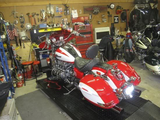

Pics of Valks on Harbor Freight lift tables.....
Canadian version of the HF table lift.....
Harley on HF table lift....
For comparison, this is the Kendon lift.  It's a fold up lift that you lean up against a wall for storage.  Looks more like a Valk on an ironing board to me.   Shocked
If I had 2 grand to blow on a lift table, I'd be tempted to buy this one.....
http://www.ezcarlift.com/accessories/MLK/motorcycleliftkit.php
A Direct Pro table lift.....

Using a sissor jack on a Valk on the HF table lift.....

  on those HF lift tables they have a removable plate under rear wheel to drop wheel and to aid in real wheel removal .  That makes it VERY easy to drop the wheel.  Remove rear shocks and let the swingarm drop down and remove axle,  Works for me.
