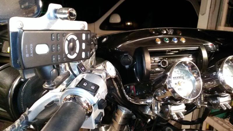

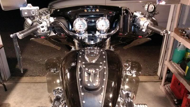

« Reply #8 on: March 15, 2014, 11:20:34 PM »
I am thinking about placing an order for a Woodies faring and am wondering about the tach/spedo relocation... mainly, do the gauges now seem to be in your face?? can you easily control the stereo while riding with the gauges where they are?? I would appreciate any input on the faring setup and rideability from anyone who has gone with GWoods faring.
Here ya go....I took some pics when I came home from work tonight (the outter fairing shell and windshield are off the bike at the moment).  Judge for yourself.....
With the head unit's face plate lowered in the down position.....
I don't think the guages are in the way at all.  At first, I had the normal reservations about putting them up on the handle bars, but after I put them there, I like them there better than before.  I can see them better now and they seem natural there to me.
Here's a short video right after I had wired up the stereo and everything else to see if it all worked.....
https://www.youtube.com/watch?v=DopsCiNyR6E
Here, you can see where, on what (Ram mount) and how I mounted my head unit's remote (it's a standard IR remote)....
I mounted one of those licence tag lighted bolts that you can buy just about anywhere to illuminate the remote for riding at night.  It's switched so that I can turn it off if I want/need.
I haven't had any issues with my remote working in direct sunlight, but it's just an IR remote and if you stick something in the way of it (like a water bottle or something), the signall will be blocked.  I used to have my Barefoot Willies cup holder mounted on the left....but with the remote, the cup holder became an issue and I moved it to the right handle bar so the remote had a clear line of site to the head unit.
As for "rideability", I don't think it gets any better behind a fairing.  You can tune it to block all of the wind, some of the wind or you can get all of the wind with a simple change of windshields.
On a Woody's fairing, you can change windshields in a minute or two.  It's nothing to change out a shield.  Losen the three bolts/nuts and pull the shield out and slid another shield in....tighen the bolts/nuts and you're done.
I have a 4" solid black thumbnail windshield for when it's sumertime balls hot and I want to get all of the wind.  I have a 7" in light tint that is on the bike for most of the year......and I have a 10" light tint shield that I use during the cold part of the year.  The 7 and 10 inch shields have a recurve at the top.  A 10" shield is about the same as the OEM Honda windseild.
I used Fast Aire "aero" shields.  These......
http://www.fastaire.com/Aero.html
There's at least one other company that I know of that offers recurve shields, but I don't have any direct expericene with them.
http://www.longrideshields.com/searchresults.asp?cat=1823

Another thing to notice is that BF installed extra neautral,brights,and turn indicator lights on the fairing. It looks really nice, but you don't need to do this. The stock lights on the headlight are clearly visible. cooldude
As far as the remote, i've actually been riding with the sun shining on the face of the radio, and no response from the remote until going under the shade of passing trees. Roll Eyes Most of the time not problem, just every once in awhile. The marine remotes tend to be IR or wired for this specific reason.

I really appreciate the time and pictures BF,, I actually like the relocated indicator lights, I think I may need to do something similar on a quick disconnect plug to add that finished touch. Although the Woodies faring is not a "quick disconnect", I can see wanting to change it out for the windshield sometimes,, sort of looks like a semi major job.

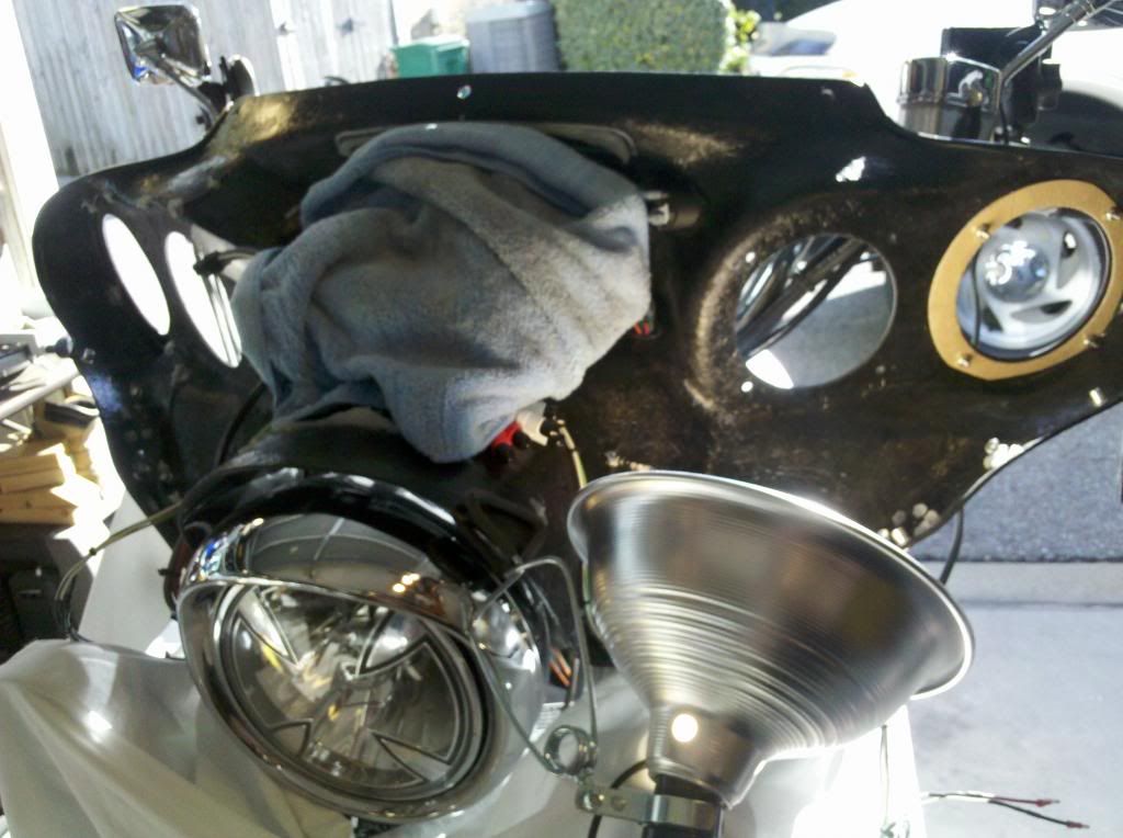

I wonder about the headlight relocation deal. Where does it go.. what does the mount look like??  I will probably cut my own handlebar clamps out of aluminum stock on a mill to get them the way I want, (sort of like doing that stuff once in awhile), and can bend out the headlight relocation piece if I know where the headlight needs to go. Also the "radio door",, is it truly waterproof.. I mean can you run in a downpour if necessary without any worries?

Pancho the headlight relocator just bolt to the back of the bucket and slides it forward just a bit and is hidden when the fairing is on.
I also relocated my signal lights to where BF put his.
Jimmy how can you see the signal indicators with the fairing on? They are covered by the fairing on mine at least. I cut the holes for mine in the fairing with a dremel and got some little plastic plugs and put them in the top of the bucket where they were and used silicone to stop water from running in.

On mine, the lights on the headlight are plainly visible between the two relocated gauges. Don't get me wrong, I like what BF did on his, but as far as function, I do not have the need to do it. The fairing actually shades those indicator lights allowing them to appear brighter than they otherwise would on a bright sunny day. I've got my front end apart. Just rebuilt the forks with progressive springs and replaced the steering head bearings. In the process of polishing my forks to a mirror shine, otherwise I'd post a pic. My Woody's is sitting in the corner of my garage at the moment. If you look at the pics of BF's up top , you'll see the neutral indicator glowing there between Bf's gauges.

Hey Jimmytee,, since you have your front all apart, could you take a picture of that headlight relocation bracket so I can take a look at it?? Also, how does your stereo perform at highway speeds?, can you hear it clearly?

Jimmy did you put the headlight relocation bracket on yours? Just asking because I don't remember seeing my indicators with the fairing mounted. Might could have but just don't remember.but looking at  BF's last picture it looks like he still has his in his headlight bucket along with the ones top mounted.

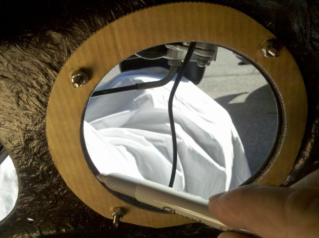

Here's a pic of XF6 Customs relo bracket. FWIW, I'm finishing up a Woody's fairing install with the gauges mounted in the fairing, no radio, and plan to post some pics in a week or two.

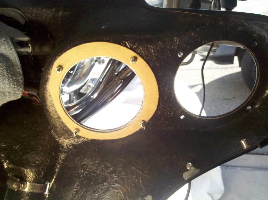

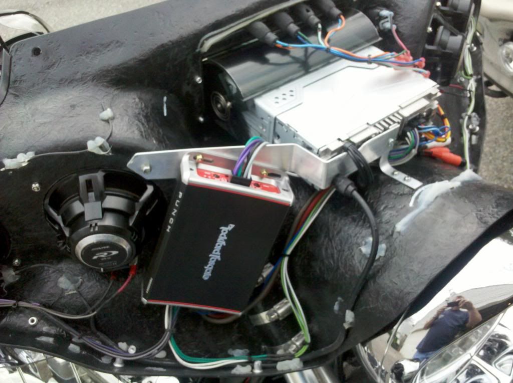

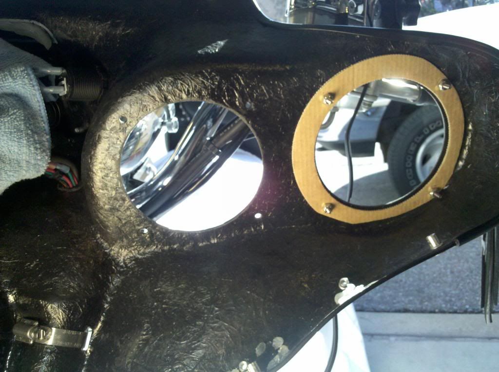

« Reply #16 on: March 16, 2014, 09:52:02 AM »
Yep, my indicator lights are still in the bucket and functional.  I looked at the parts fisch on Directline and ordered an extra harness and bulbs to do what I wanted.  I used the wiring diagram from the Interstate to figure out how to wire in a left and right turn signal.  I just spliced into the harness in the headlight bucket to wire how I needed and ran them up to the fairing.
The above pic was when I was wiring in my amp.
Without an amp, and the speakers that Glenn provides with the fairing, you can hear your stereo pretty well around town......full-on highway speeds....not so much.
I installed a Rockford fosgate 4 channel 300 watt amp and replaced the speakers with Alpines.  I can jam at any speed.   cooldude
The speakers that come with the fairing are 5"....unless Glenn provides something else now.  If you upgrade to a better speaker, they'll most likely be a 5 1/4" speaker....and you'll need to enlarge the holes a tad.  I did that with a drum sander on cordless drill.
In this pic, you can see how the fairing is attached to your bike.  There's six clamps total.  The Woodys fairing IS NOT a quick disconnet fairing.  I installed mine to stay there.  I can't imagine EVER going back to a standard windshield....not even for a little bit.

Thanks, that picture is what I was looking for,,,, look forward to seeing pictures of your custom job. After looking at jimmytee's install pictures Bighead posted,,, ya start wondering if you could fit 6.5 inch speakers in there??
Thanks for digging that posting up Bighead, there is a lot of good info in those pictures about the install. I think I had just finished mine up last year when jimmytee was posting that, and probably too busy riding to check the board!!! At least that's my story for not remembering it!!

Thanks BF,, now I'm getting all the pertinent info and seeing everything I want to see.
Looks like that Rockford Fosgate Punch is about the right size for that faring..... nice clean work

I installed 5 1/4" Kicker speakers and used the grilles cut from the 5" speakers the Glenn shipped.
I mounted my speakers from the backside and did not need to enlarge the holes like BF did. Just a thought. Either way is painless.
