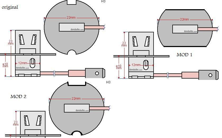

You will have to modify a H3 to fit. But it is not very hard. When you pull out the old bulb and compare it to the H3 you will see what needs to me modified.
Here is a picture that shows a couple of cuts I have made to make the H3 fit.
