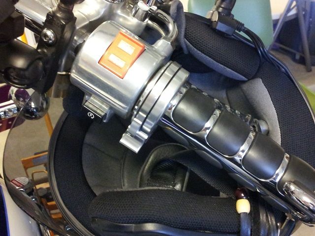

Have this one on my Pacific Coast.    coolsmiley
And nothin,, as of yet,,, on da Valk...    ???

I used a brake-a-way lock on my Standard and moved it to my IS after the Standard was totaled. It is by-far the nicest throttle lock I've seen and the fact that it unlocks when you pull the brake lever is a nice safety feature. One thing to keep in mind: if you install wide aftermarket levers, they will no longer turn the lock off when you pull the brake lever. I added wide, adjustable Kuryakyn chrome levers and I lost that function.
I ended up installing the Audiovox cruise control. I kept the brake-a-way on in case I didn't like the CC, but removed and sold it pretty soon after. After being spoiled with the cruise, there's no way I'd bother with another throttle lock again.
What Audiovox cruise control did you get Nitro??... I don't see a motorcycle specific one.
I just saw some information on the CCS-100 being used on motorcycles,,  I wonder where does the vacuum servo fit, and can you use a coil for your speed sensor/motor rpm signal?
« Last Edit: May 07, 2014, 03:28:41 PM by pancho » Logged
NITRO
Posts: 1002
Eau Claire, WI
« Reply #31 on: May 07, 2014, 07:16:25 PM »
I used the ccs-100. I installed the servo in my fairing. And yes, you write it to a coil for engine speed.
Check out Shoptalk, there is an excellent set of instructions there with pictures.

Installed one five years ago, has never given me a problem.   Mounted in the Fairing and all electrical connections can be made in the Fairing as well.    Used the Pingle Slimline Switch on the handlebar, looks factory.

When you say "electronic rosta', I assume you are talking about the UlraCruise 250-1316 ..??  I wonder if that unit can be wired to the neg side of a coil for it's speed sensor pickup like the CCS-100.

You can install the CCS-100 without a vacuum canister as well. I used all except #6 for vacuum when I did my install.
Same here, but I only tapped two of the intake for vacuum, works perfectly.
