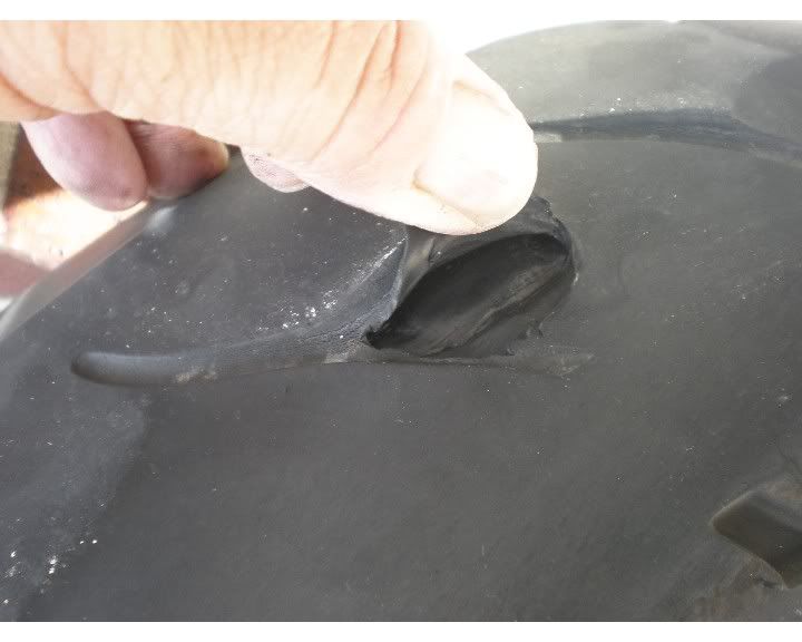

OK you VRCC Tech gurus....Have the rear wheel off of the Valk to fix the mismatch Rotor / Wheel issue...I serviced the rear about 1 1/2 years ago...didnt take pictures then, but heres how she looks now..30,000 miles roughly currently, Ive put about 10,000 on her since rear end was last off.
So what do ya'll think?

Well, I am no guru but it looks pretty good.  Needs cleaned up and new grease slathered on.  I am right now changing out the rear tire on my I/S.  What works real good to get the old grease off is brake cleaner.  Don't get it in the bearings.

Looks dry and crusty...but not significantly worn.
Clean and grease. Be sure and pop the star off the rear wheel and add a little grease in there with the thrust washer. Also the face of the bearings. I find sealed bearing last a lot longer if you dab a bit of grease on their sides/faces whenever you're in there. Keeps extra water/dust from attacking their seals.
Check the conditon of the 3 o-rings. Replace as needed.
http://valkyrieriders.com/shoptalk/Elusive%203rd%20O-Ring.htm
Be sure and loosen the four bolts on the final drive and tighten them AFTER you torque the axle when re-insatalling the wheel.

Looks OK.  Clean it up and grease it.
I use kerosine to clean off the old grease.

30,000 miles you got lucky.
