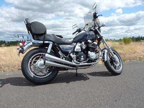

Not to be conterversisial,  but that's an old GW, probably a GL 1000, not a CB. The engine in the bike shown is a flat 4 not an inline 4. Attached is a picture of my 1983 CB 1000C with an inline 4.
Salty1, I think you are referring to the picture posted by Gryphon Rider , not da prez.
