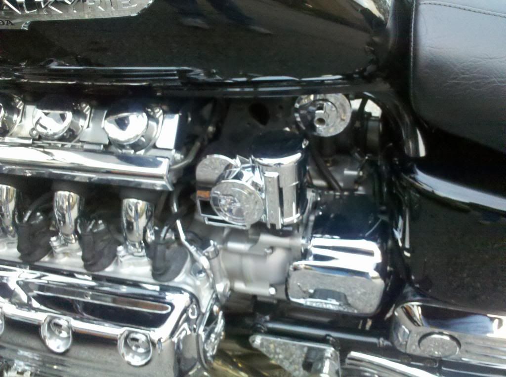

I like my Wolo Bad Boy http://www.amazon.com/Wolo-Model-519-Chrome-Design/dp/B000PWZR4C
I like it because it is a one piece unit. Mounts nicely under where the fuel shut-off is located. The horn puts out a good solid blast that can be clearly heard at highway speeds.
You will need to wire in a relay because it is 12V (more sound = more power).
Here is a pic of my bike with the Wolo installed. So clean you barely notice it's there. Look below the fuel shut-off is.
Hope this helps.

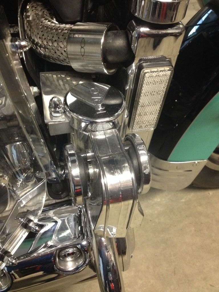

« Reply #19 on: April 23, 2015, 08:39:17 AM »
Hi All,
It took me a while but I ended up buying a Stebel Nautilus. Can someone please share how they mounted it next to the fuel tap?
Many thanks,
Mark
I also did not mount my WOLO in that location, but all it would take is a short metal strap with two holes attached to the lower coil mounting bolt.  I tend to use aluminum strapping material available at any large building stores.  It is available in three foot lengths and various widths and thicknesses.  It also easily polishes up to look good.
I mounted my WOLO where the OEM horn was mounted on the Tourer, but the bracket took a lot of trial and error engineering to get it done.

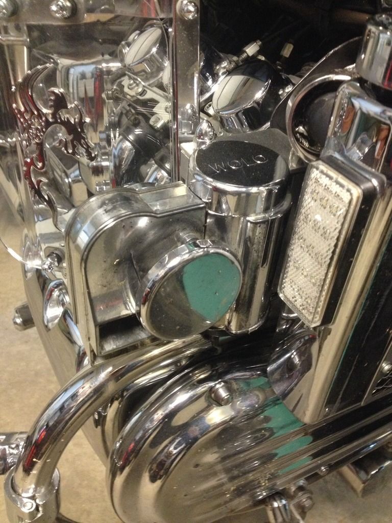

« Reply #21 on: April 23, 2015, 10:54:44 AM »
Hi All,
Many thanks,
Mark
Bob, how about some pics. Have mine by the petcock and don't like it there. Thanks

BobB
Posts: 1568
« Reply #23 on: April 23, 2015, 03:00:23 PM »
Dave,
The horn takes a lot of abuse at this location and as you may see, the chrome plating does not hold up to well.  This is the second WOLO Chrome that I have had there in eight years.  Removed the first due to this but just installed it in a cage...
« Last Edit: April 23, 2015, 03:03:02 PM by BobB » Logged

I put a slight little z-bend in mine to off set it back under the tank just a bit.
I mounted mine here.....
« Last Edit: April 24, 2015, 01:18:51 PM by BF » Logged
