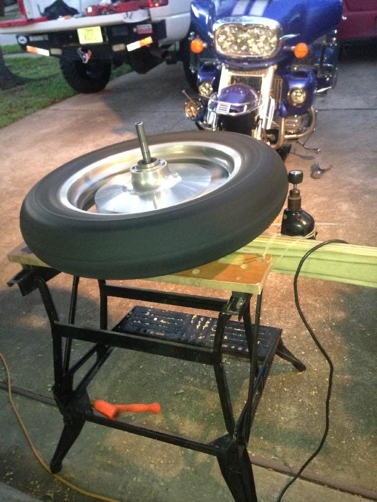

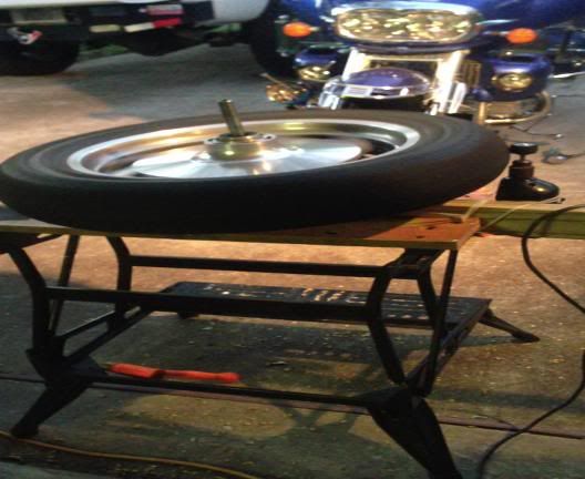

Here is my rig I am using to polish my front wheel.
Too redneck?  Hehe
Works pretty good.

I'm more interested in the base of the axle. What/how do you have it spin on?

I think we're going to need some details on that! cooldude
Posts: 7518
« Reply #8 on: April 11, 2014, 08:09:10 AM »
I took a 2X4 on it's edge and with my 7/8" wood bit drilled a hole about 2 inches down.  The shoulder of the front axle is between 7/8" and 1", so I wollered (technical term) out the hole until the shoulder of the axle would just barely start.  I then took my dead-blow hammer and drove the axle into the hole with the plastic end of the hammer.
I clamped the 2x4 in the B&D Workmate bench and added another 2x4 to strap the drill to.  I clamped both of them in the bench and tapped the 2x4 with the axle in it until the tire just touched the rubber fixture in the drill.
Guys that use their drill presses to spin the tire can spin it faster, but this is what I had on hand at the time.

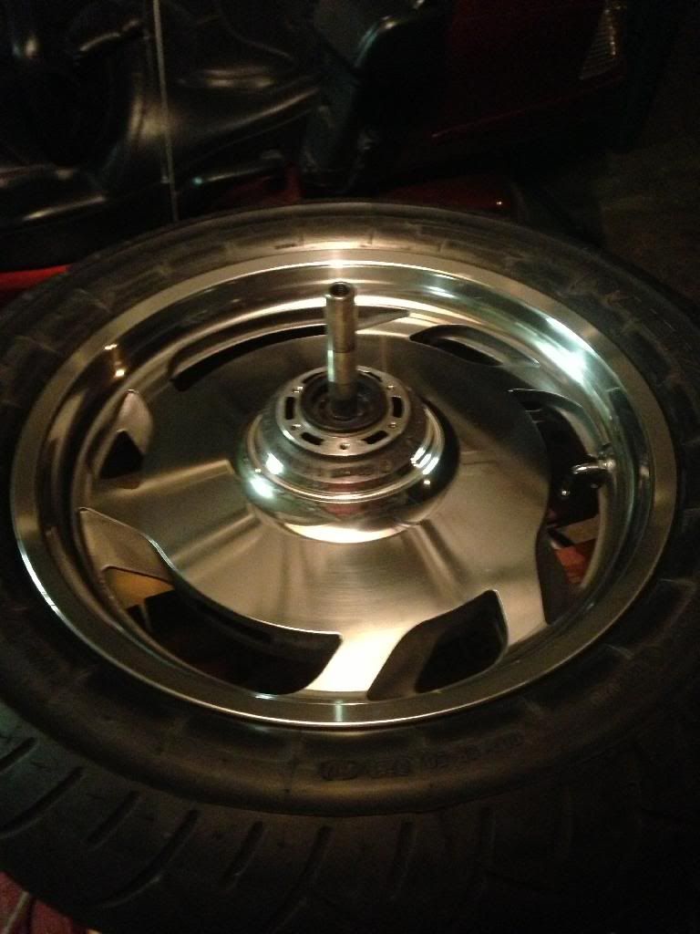

I wish I could get it to spin a little faster.  Need a little larger diameter device to spin in the drill.  It really goes too slow to get hurt.  Besides, you can stop the spinning if you press too hard.
I started with 320 sand paper, then to 600 and then 800.  They are now smooth with no machine lines.  I will start with the different colors of rouge this afternoon.

MarkT, that is where I got the idea for my redneck rig.  I just used what I had laying around.
Well, I used red rouge then white on 2 different 5" wheels on my small grinder.  I think it came out pretty good.  I just have the other side to do then I can get the new tire mounted and put the bike back together.  Smiley

That really looks nice Jimmy, great job.
Posts: 7518
« Reply #24 on: April 16, 2014, 10:19:13 AM »
Now I have to do the other side, hit them with the Mothers polish (power ball) and get the new tire mounted.  This weather is killing me not being able to ride.
I am going to try some stuff called ShineSeal to seal the finish on the wheels.  I will report back as to how it protects the shine from getting dull after some time.
