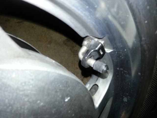

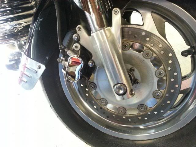

Had a good ride yesterday up to the Lakehouse at Beaver Dam Lake, Wisc. Got less than 20 miles from home and my front brake lever pulled all the way to the handlebar. Made a decision to carry on, even though it might not have been the smartest. I had a job I had to get done up there.
I was there for about 20 minutes and came home. I used a combination of downshifting and rear brake.
I know someone will ask about how I lost brakes. I'm still not sure but it is related to chrome caliper covers I just put on. I didn't pinch any lines that I know of but it's the last thing I installed before the loss of brakes. There were no visible leaks anywhere, including at the calipers. My reservoir remained all the way up over the window with fluid(which was changed last year).
When I got home, I removed the chrome caliper covers and my front brakes pumped up with two squeezes of the lever. My brakes now engage fully with about an inch of pull-just like before.
The covers have longer bolts and spacers that mount up to the original 2 caliper holes. I'm not sure if somehow my calipers got in a bind or what. Even that wouldn't explain why my lever had virtually no resistance all the way in to the handlebar.
Anybody run in to the same problem or have any thoughts? I'd welcome any ideas.

I'm sorry to hear you had a problem.  When I got the covers I ground the space that the hose goes thru because I was worried that might cause a problem.
I also got some clear tubing and slit it then put that over the end on the cover just for peace of mind.
I'll be watching to find out the problem myself.  I'd hate to think I sent something that caused a potential accident.
Steve, I'm not blaming you in any way, shape or form. I'm going to experiment with them in the next week or so...when I get some spare time. I really can't see any way they could have caused that condition by the way they bolted up. The spacers are the ones that came with it, right?
I'll let you know what I find, if anything. Any potential accident would have been my fault...period!

I have had the same covers on for 15+ years and no problems rubbing lines or anything else I don't think that they are what caused this. There is no way that removing two bolts and replacing said two bolts with spacers and longer ones had anything to do with a brake lever having no pressure. But that is just my opinion. But seems impossible that two bolts that have ZERO to do with the brakes themselves caused this.
Bighead, thanks for chiming in. I agree with you 100%.  I do have the small chrome covers on my calipers that I left in place when I put the bigger covers on. Maybe this created a bind somehow. You're correct in the fact that I just removed the existing bolts, installed the longer ones through the covers..then the spacers...into the existing holes. What I do know is that I had brakes before the install, lost them...and then had them restored after removing them...without doing a thing besides removing them. I tried the brakes at least 10 times during the trip and had no stopping power with the front lever.
I'm going to remove the smaller covers and retry the caliper covers and test them out in my garage/driveway.  I'll post the results after I try again.

Wiggy I guess they could have been in a bind with the extra piece on there but that would seem to me that they would be dragging the whole time Undecided

Did it feel like there was any drag?it may have boiled the fliud.If the covers were binding you still should nave been able to pump up some feel.
Excellent thought, but no, there didn't seem to be any rubbing. I would have expected if there was drag, I'd get the smoking semi brakes smell. My pads aren't any worse for wear.  I also agree  with you about being able to pump up and create pressure.
We have a cold rainy snap coming through Illinois now, but in a couple days, I'll see what happens with the other chrome covers removed.

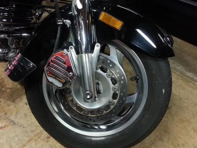

Problem seems to be solved.. Thanks to all that responded! Joe, you were correct with the pic. They are ShowChrome Caliper covers. This is a pic of what I had on the bike and I put the showChrome covers on without pulling off the smaller chrome covers.
I just went out into the garage and yanked the above covers off and reinstalled the ShowChrome covers-which look like this.
Now my brakes work fine. I WISH I could say somehow I screwed up and put the covers on upside down or something stupid because I have no problem admitting to a brain fart. But I'm thinking somehow the other chrome covers messed up the distance the spacers took up. That wouldn't explain the seeming loss of hydraulics when pulling the lever to the bar...but it is what it is.
I'd like to thank Saddlesore for selling me this hard to find "set". I LOVE them and apologize for throwing a scare into you. You're a class act, Steve.

Off topic but are those the original valve stems?  Don't want any other problems. cooldude
Steve,
I agree I could try to recreate what caused it but I'm happy that it's now ok and not wanting to beat a dead horse.  I appreciate your concern about the valve stem. Mine are both metal replacements.
It just doesn't show it with the cap and plastic support blocking the view of the stem..
Here's a different angle.

« Reply #32 on: April 16, 2014, 08:27:40 AM »
Installing the larger covers on top of the smaller covers that are on the caliper
pushed the floating calipers to the fullest extent of their travel range, also pushing the
pistons in to the caliper completely to bottoming position.
Then, when depressing the brake lever, all that happened was that the caliper
moved, trying to access the rotor. Braking failed because the movement of the caliper
consumed the full action of fluid movement provided by the brake lever.
Releasing the brake lever simply allowed the spring action of the larger (new) cover
to again push the caliper back to it's extended position.
Simply put: All the lever was doing, was moving the caliper back and forth on it's pins.
That sounds like the best diagnosis yet, Ricky.  I'll buy that.
