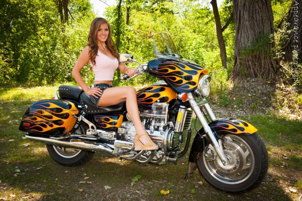

I saw this the other day and was wondering what it was. Not the thing sitting on it, quite familiar with them. I'm talking about the lever above the passenger floorboard, I thought it looked like it might be a reverse.
Gryphon Rider
Posts: 5234
2000 Tourer
Calgary, Alberta
« Reply #2 on: April 16, 2014, 02:56:18 PM »
The lever in the photo above looks like it swings forward to be a forward-position passenger foot peg.  Never seen it before.  It's not connected to the transmission, so can't be a reverser.
Glad you pointed out the lever, I never would have seen it.  angel

Well, I didn't notice it right away either.
whooray and I just purchased that bike. When we get her home we will let you know. Or, you can see it at inzane. Raymond is picking the bike up in Min. And riding it to inzane. Then back to Idaho after that. I think it's just a folding passenger peg though.
OnaWingandaPrayer
Posts: 617
« Reply #25 on: April 18, 2014, 11:30:44 PM »
   did the bike come with the seat warmer ? it looks like a nice option . cooldude
I had the flame bike at my house from April 20 till Raymond picked it up on June 6th.  those are one of a kind passenger foot pegs that swing back and forth. made by the owner of the bike.  ask NOGREY if he could take some photo's to post.  T.P.
