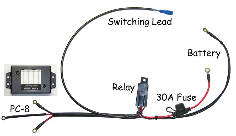

« Reply #8 on: May 03, 2014, 04:57:12 PM »
Like the other guys said......here.....
That's where I took the switched power for when I installed my Eastern Beaver PC-8 block.
You can see the black wire running up into the rubber sleave.
The PC-8....

« Reply #10 on: May 03, 2014, 06:47:45 PM »
The PC-8 has 8 circuits.   Wink
http://www.easternbeaver.com/Main/Wiring_Kits/Fuseboxes/PC-8/pc-8.html

« Reply #12 on: May 06, 2014, 09:38:40 PM »
I went with this unit as suggested from BF and used 4 and still have 4 for future lights or something else angel

« Reply #13 on: May 07, 2014, 10:05:26 AM »
I also ran with the PC-8, but wired it differently so that one of the eight fuses (30 amp) was used to protect the box.  That way the separate external fuse was not needed.  I have only three circuits for accessories, two switched and one battery.
