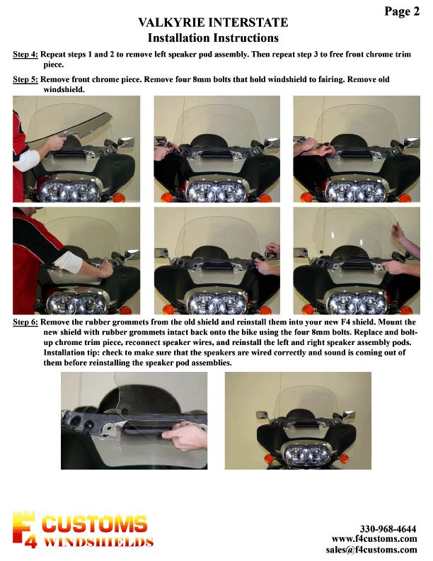

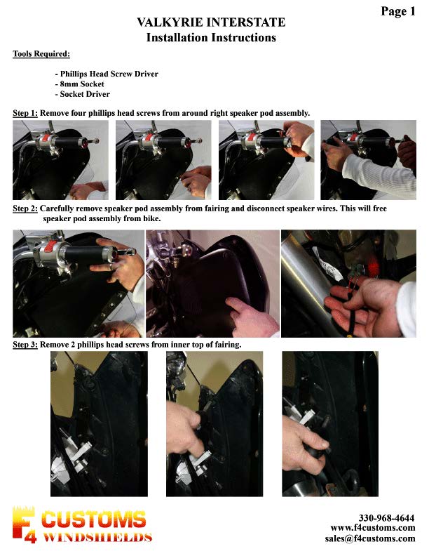

I found these instructions helpful. I also had insert problems and used JB Weld as well as anti seize.
« Last Edit: November 25, 2019, 06:27:36 AM by ShiftHappens » Logged
