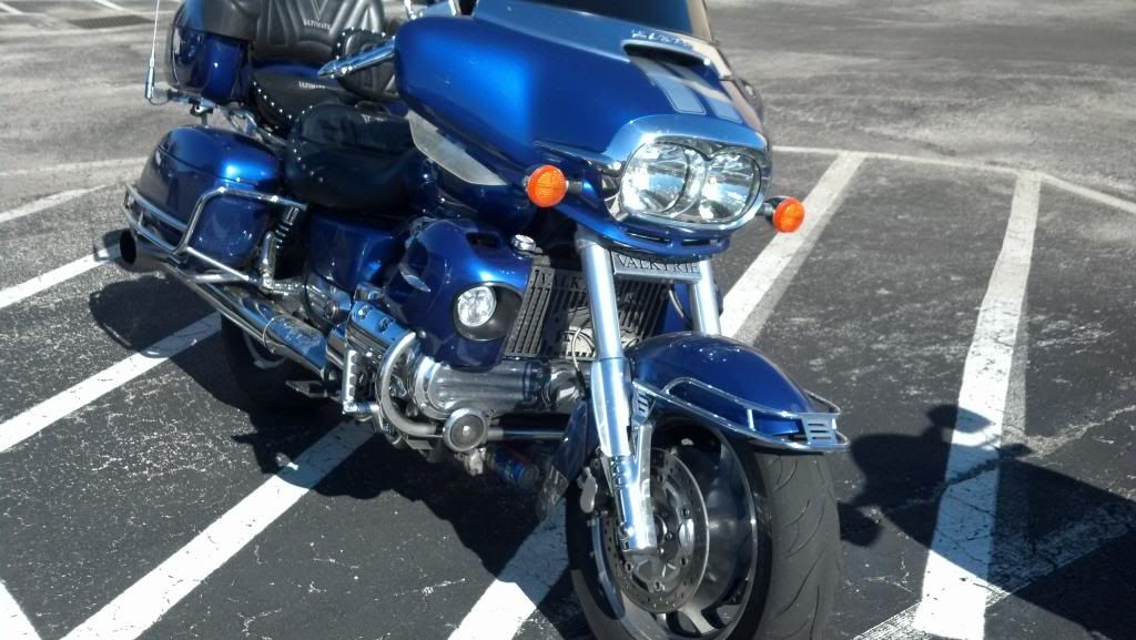

Posts: 7262
« Reply #21 on: May 23, 2014, 09:06:32 AM »
Jess, I just trimmed a BudLight can and slipped it over the yellow filter.  Blue and silver, matches my bike.  Smiley
You can sort of see it in this pic.
Hay  Cool
« Last Edit: May 23, 2014, 09:09:38 AM by HayHauler » Logged
