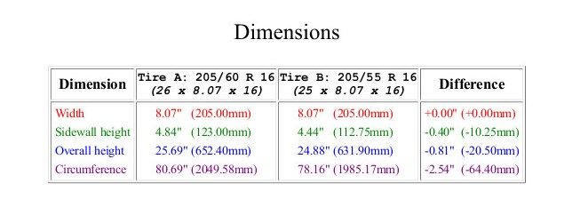

I thought the 55,60,65 designation was a height percentage of the width (205)? Which would make them all 205 cm? Wide and the 55 would be that percentage of that in height. Have I got this wrong?
You are correct.  The 55 tire is the same width, but slightly smaller in diameter.
(Minor correction: the width is 205mm, not 205cm.  205mm is about 8 inches, 205cm is almost 7 feet.)

It's true Jess,, what meathead explained is correct  ...
Well, I got the tire today,, just sitting next to my Avon, you would not think it would not fit on the bike!! it looks huge,,   I like it.

One thing,, I got a tire with the 55 profile, and should have gotten the 205/60 as the 55 is quite a bit smaller in circumference than the recommended 180 tires that go on out bikes. THis is going to up my RPM's at any given speed, and reduce my gas mileage...  Well,, thats OK, this is really just a test to see what the car tires are all about. I'll let you know what I think when I install it, and ride on it in a month or two.
you got it correct 205 wide is 205 wide and the height is the 2 digit % of width
