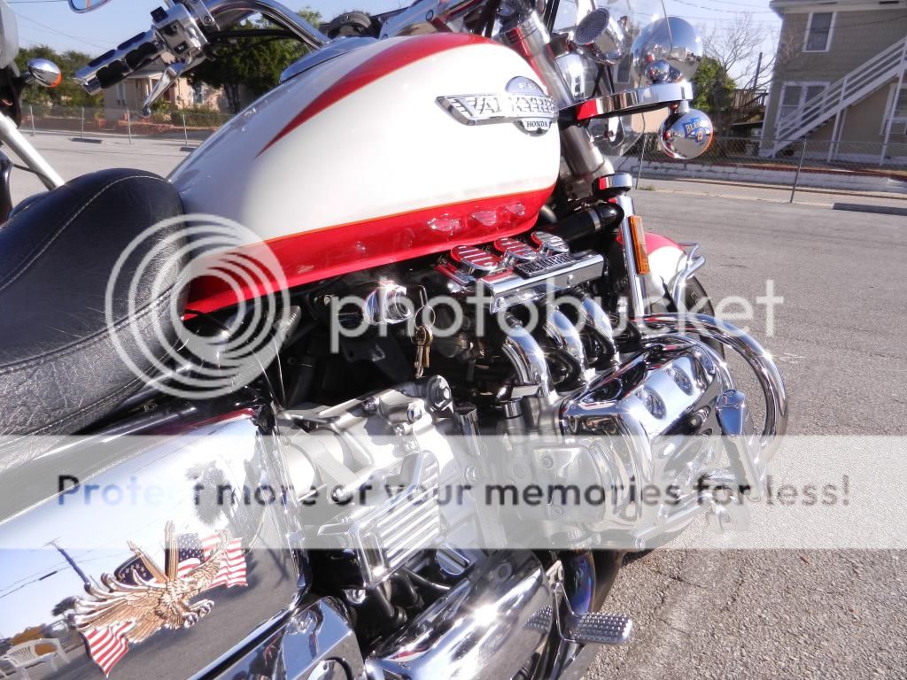

Its been a while.  I didnt know it was supposed to be hard to do so I just removed the bracket and I didnt have to bend a wrench.  I didnt touch the radiator either just removed the horn and its bracket, it was no big deal.  I think I used a socket and my long extension.........
PS...I went out and looked.  Mine was mounted on the end of that old "buzz bolt" so the other end of it is on the other side of the bike, not behind the frame.........so no problem. The way the bracket is designed with a tab that fits behind the down tube of the frame, the buzz bolt location is the only place it fits.  So yours is probably at that location too.
Moved the horn to here
