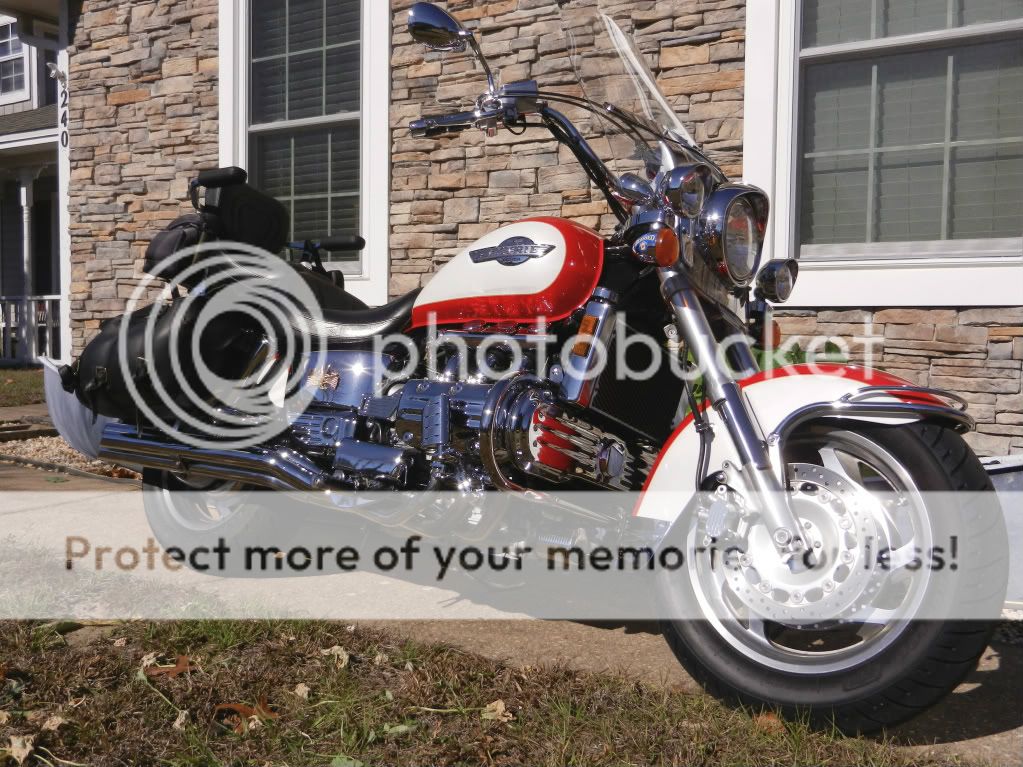

« Reply #3 on: June 05, 2014, 04:36:20 PM »
Mine was running very rich too.  I changed to a K&N filter WITH the pre filter and now its puurfect.  Mine was rich because of Cobra pipes and no jetting.....now its the fastest 97 around........but thats because its a '97 and its a red and white
