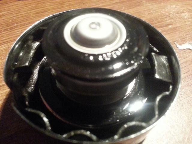

Thanks for chiming in, Patrick. Yes, first thing I did was loosen the retaining screw before removing the cap. I actually backed it all the way out. I do have a chrome cover over the original cap but that's never been an issue up till now. Looking at the picture below, I'm not sure at what angle the two locking tabs should be, slightly upright like in my picture, or straight across, parallel with the cap.
When my new cap arrives, I'll be able to compare em...but then again, this isn't rocket science..it shouldn't be too difficult to figure out. grrrrr
Thanks to everyone for their suggestions. I first checked to make sure the line was clear back to the overflow tank and it was. Then I took Patrick's advice and bent the tabs down quite a bit from where they're showing in my pic . They're now straight across and parallel with the bottom of the cap. I'll still put the new cap on as this one might be original and 15 yrs old. It must have had a good seal even with the tabs in their previous position but once I removed the cap for the coolant change, it couldn't re-establish that seal.  Thanks, Patrick!
