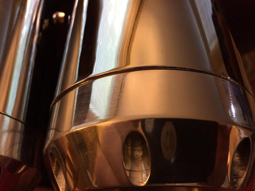

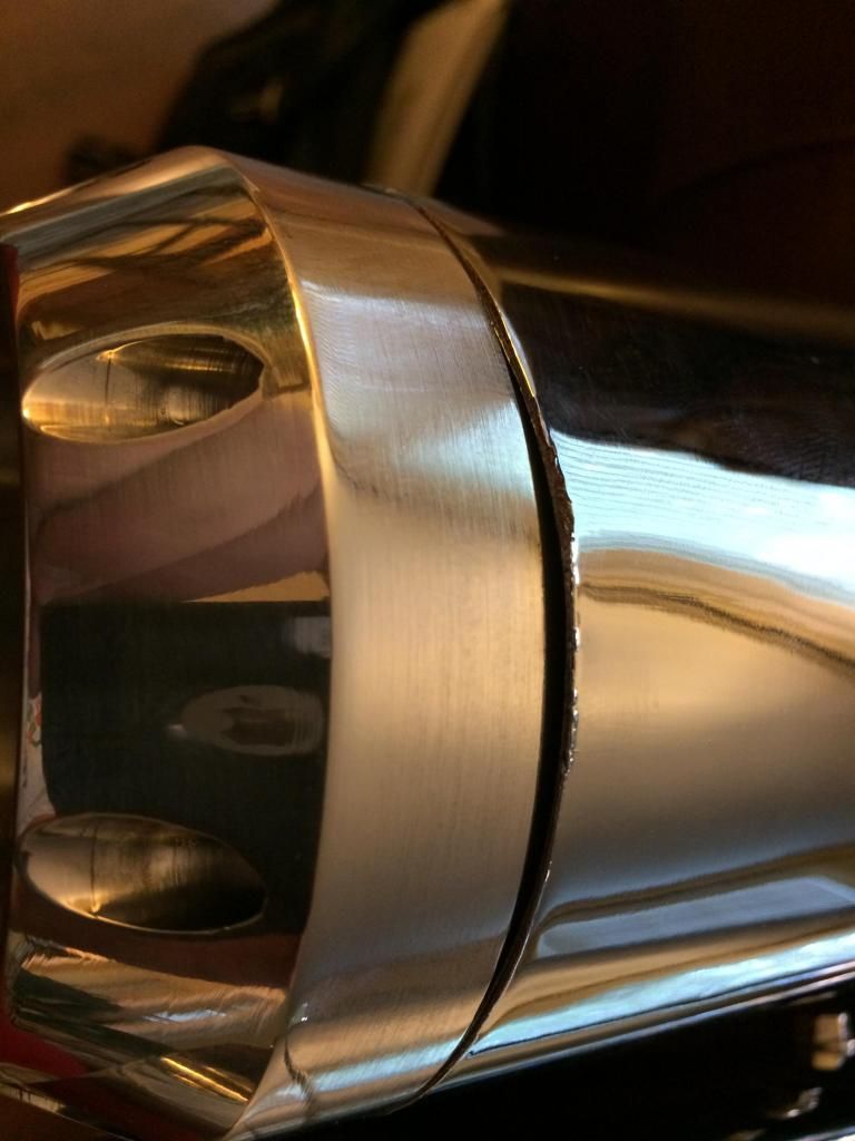

I just received a set of new exhaust pipes and haven't installed them.  The problem is that the left side pipe is noticeably out of round, not cut flush, and gnarled up.  I want to put my new set of grumpy's tips on, but to me it is pretty noticeable.  I was thinking of taking to a machine shop and have 1/4" off to flush it up, but I would be exposing the metal on the end by cutting the chrome.
Any thoughts or advice would be helpful.  Maybe I'm just being too picky.  Honest feedback is appreciated!
The "good one"
The "rough one"

« Reply #1 on: June 27, 2014, 11:09:14 PM »
Cashman,
             Go to your local truck parts stockist or a marine workshop, get a couple of stainless steel exhaust clamps the correct size for your exhausts. When fitted with the pinch bolts underneath they will do a good job of covering the ugly gaps you have.
The band clamps have a small degree of flex to them, which may be able to adapt to the slight taper of your silencers.
Maybe not the ideal solution but would be very easy and cheap to do.

« Reply #2 on: June 28, 2014, 06:04:09 AM »
You could wedge them at the bottom, pulling them into shape on the top.
Unlikely it would be noticeable.

« Reply #6 on: June 28, 2014, 08:24:22 AM »
I built these pipes.  The issue here, is the chrome industry is caught "between a rock & hard place".  I have bought stacks from many many American suppliers over the last 15 years.  They are hamstrung by the EPA and their pollution standards (partly thanks to bad publicity from liberals and Hollywood, in particular the movie "Erin Brokovitch".) They have to compete with offshore chromers who don't have such costs. So quality slips or prices skyrocket, sometimes both. Thanks to the govt, nowadays the best stacks for the money comes from offshore - Mexico, Venezuela, and China. Add to this issue, UPS is BRUTAL to chrome, and that's who most or even all of the stack suppliers use for shipping as they are a few pennies cheaper than Fedex.  So if the chrome I get is quality from the factory, UPS damages it.
My current main source has been good about backing me up on the quality - if they send chrome that doesn't meet my standard (or their shipper damages it) - and they know what it is - they send me a replacement immediately, usually 2nd day.
Cashman's build passed inspection because the chrome is very good.  I photograph all builds as part of the QA process - don't see the blem that showed up in his closeup shots with grumpy's tips installed, but I don't do super closeups - if I did then obviously there's a reason for that, sufficient to reject the product in the first place.  It's a known fact, that stacks aren't round - I document that on my exhaust page and in my docs.  They are made by rolling and seam welding a flat sheet of 0.065" steel, then chromed.  They look round, but it takes some effort to fit silencers in them as they are somewhat oval.  I even designed and built a hydraulic expansion press, that inserts into a stack and pushes outward HARD to reshape it for better roundness w/o damaging the outside finish. The stack's out-of-roundness is not a cause for rejection as they are ALL somewhat not round.  That doesn't really show up until you put something really round in them, like Grumpy's lathe-turned tips.  Typically, fitting them into the stacks will force the stack to be round, at the tip.
Now what we're seeing here is the stack is also blemmed on the end.  Maybe from shipping.  Or maybe in manufacturing and I missed it.
I've told Cashman,  we'll get the supplier to send us another and I'll prep it to fit, and Cashman can install it.  He'll need an angle grinder with a cutoff wheel to cut the tack weld that holds the stack in place during shipping - ~$20 @ Harbor Freight - a hammer and block of wood.
And I'm thinkin that will fix the situation.

« Reply #8 on: June 28, 2014, 12:08:50 PM »
Looks like possible shipping damage to me.
Thanks,
~Farther
« Reply #9 on: June 28, 2014, 03:04:11 PM »
I agree it looks like they were dropped on end.

« Reply #11 on: June 28, 2014, 11:41:15 PM »
"I was thinking of taking to a machine shop and have 1/4" off to flush it up,
but I would be exposing the metal on the end by cutting the chrome..."
+1
I would do both pipes (same length). After cutting, touch it up with silver-color rust-suppressing paint.
Good Luck.

« Reply #17 on: June 30, 2014, 05:20:00 AM »
Just take a belt sander to it. Only take a few min. Put a little paint on the ends and your good.
