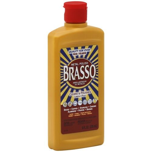

Got another question. What's the best way to clean the float bowl covers? I tried carb cleaner and it did nothing. When it's dry I can chip little pieces of varnish of but doing the whole bowl cover is a bit much. I have them soaking in mineral spirits now hoping that will soften it up so I can flush it out.
Have you ever tried Brasso, amazing stuff.

I'm sure that Brasso and a healthy dose of elbow grease would get the job done but I'm not sure I have the latter.  Undecided

Just let it soak awhile, it won't take much elbow grease.  cooldude
