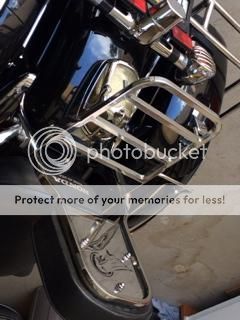

It's  built strong you can't break it, baring you don't use it to tow the boat
You mean like this? 2funny (My Dad would try just about anything.)
Hey! My uncle had a bike like that... BUt without the canoe & trailer...
